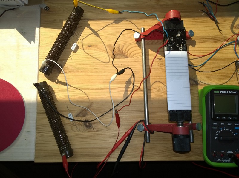

Below the photo I had in mind. This is about testing the power capabilities of the supply on the (poweramp) board which you see in the right. Btw the white paper covering the board is not to hide secrets but to avoid short cutting.
In the left you see two lousy 5 Watt resistors (the little white) of which I thought at first could do the job (create a load on the amp). But I left my brains somewhere I forgot and when I finally found them I saw that there's 63 Watt on such resistors for the 4A I wanted to test. So that required quite something else, and that is what you see now (these are 300W and 1Kg).
Next it is easy to make the mistake in thinking that you use a supply of 2x 3A and thus 6A in total which is enough for the 4A, ... while the 4A is also x2. Yup (plus and minus).
Comfortable was the mistake to forget about the 0.5A fuse in the 230V mains (towards transformers) because that blew and prevented the power supply from going through the roof.
So, funny, that just testing something for its capabilities requires something otherwise not in order.
Of course when something was changed for the better on the board and a first real measurement was about to take place, someone make a shortcut with the measurement probe and the board was blown before it could be tested finally. So had to make a new board (and cover it with paper Wink).
The result ?
Not known yet. But at least 24 hours passed 1eye ...

« Reply #153 on: April 16, 2015, 11:06:07 am »
Haha, it works ...
For the not-so-insiders : when I mention +/-15V this means plus 15V and minus 15V. So two separate voltages, one plus, one minus (so it does *not* mean "around and about 15V").
But this is only the first part which is about the "ultra low noise" power regulation of the power amp board. It is only that we couldn't test more than 2A for either the plus and minus supply because we lack the power resistor to do that in good fashion for the max 3A (plus and minus) the main power supply I use for this can take. But I see no reason why a bit more current swoon won't work just the same.
The beauty of it is that totally nothing heats up even a single bit. So total draw is 4 Ampere and all stays at ambient temperature. OK, those resistors get a little warmer.
For insiders : Input voltage is +/-15.8V. The regulated (output) voltage is +/-15.56V. So here's the big trick in "nothing heats up" because there's hardly any voltage drop (it can really be zero but I like to have a little headroom for at least this testing).
Next up will be the noise (ripple etc.) measurement from this. Not sure what this will be worth at the moment, because the main power supply I'm using is a lousy one. But I need to know, because next in this little project will be the gain stage, which btw still is not the power amplification (that's behind that stage). And that stage too will exhibit noise and of course all should be the lowest ...

« Reply #154 on: April 16, 2015, 12:20:26 pm »
I get the gist of what you are doing now.  So the onboard voltage regulation components are very well matched and don't dissipate much heat and so where the amps will be will stay cool as a result.  Obviously this is secondary regulation...will the primary regulation be Class A in the other case/chassis?
Anthony, maybe I can imagine something with "Class A" in this realm, but the variation in (primary) supply should be 0.1V or so while it is not the intention that some heat steaming regulation is occurring *there*. So all is matched, but theory for now (like 18VDC secondary nice 150VA transformers (one per 2ch) I have in mind but which have to come from China and must be tested first).
