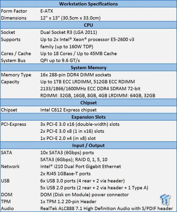

Peter, if I understand correctly the use of a dual CPU motherboard is overkill for this application (as a music server which it will not be to start with and maybe never). I am sure this is the case.  But there are other advantages to using the X10dac motherboard such as the presence of the LSI/Avago SAS3 controller which is described in the review on "servethehome.com website" as:
"Probably the biggest standout feature of the Supermicro X10DAC is the onboard LSI / Avago SAS 3008 controller. The SAS3008 is a cacheless HBA that can be used either in IT mode (HBA) or IR mode (RAID 0, 1, 10). The SAS 3008 is a very fast controller that features eight 12gbps SAS3 ports. As we have seen already with some of our SAS3 benchmarks such as the Toshiba PX02SMU080 800GB drive we benchmarked recently, it would not be hard to populate this controller with eight drives each capable of over 1GB/s transfer speeds. When this controller is combined with the ten SATA 3 ports, one has up to 18 storage ports available using onboard controllers."
In other words, the use of this motherboard gives me a slice of my cake and I can eat it as well. For the time being, I use it in my main XXHighend PC and later on I harness its storage potential to utilise it as the centrepiece of my music/file server.
Building an XXHighend dedicated/optimised PC at a later date should be relatively painless given that it will consist of just the two processors and the RAM. I may not even need a graphic card if it can be configured for headless operation so only the graphic card in the music server is used to hook up to a monitor.
Maybe there is something fundamentally wrong with what I see to be the logic behind the approach outlined above. As things stand however, I am not sure what that might be other than the use of an additional CPU. OK sure this adds to the cost but for now it will be used as both music server/Playback PC and the Supermicro X10dac seems to be a good interim solution.
rgds
Rakesh
[/i]
Nah ... There is no single way that you are going to utilize any of this. Not even for one (fast) port. So this is not overkill, it really is "rubbish". Think like having a large V12, drive that out of a cargo plane (up in the air) and think you will be down faster with that V12.
(thinking of it, you will be faster down because it weighs more than a line-4 motor)
So there are a 100 other things that determine the overall speed (of in this case file transfer) and you wont gain a thing on it. Too difficult to explain, so you'd have to trust me.
Also, by the time you can utilize that amount of disk ports and thinking of today's (or just tomorrow's) hdd's of 8TB, you wished you have invested in a factory of ripping machines for which wasn't $ left anyway because the millions of albums are too expensive. Next you must also have an 8 channel system at least, so you can listen to 4x stereo at the same time in order to listen to 1% of those albums for the rest of your life.
Have the cheapest for this but try to get some SATAIII ports because at some stage some speed can be handy (like when making a backup copy).
There is much (more) to it to make things fast but there is also much (more) to it to make things "slow" becaue irrelevant. Just don't even think about it ... that would be my idea.

I am trying to attach a picture to the specifications of the Supermicro X10DAX motherboard. I would welcome your opinion (and anyone's else who cares to contribute for that matter) as to whether it is any good for my purposes?
Maybe I should clarify what are my purposes even if it is not evident from the above? Well to have a single pc that will make use of XXHighend, use 2 processors and be fairly stable/reliable over time. Eventually maybe migrate all the hard discs including OS discs to another pc so this motherboard could be dedicated to just playing music files during playback and nothing else.
Best regards

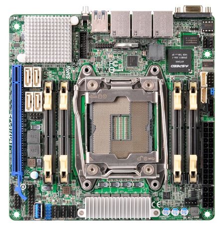

« Reply #42 on: May 21, 2015, 04:58:32 pm »
By the way,
for those who are interested in a really minimalist set-up for an XXHighend PC, you might want to consider this soon to be launched mini ITX LGA-2011-R motherboard by Asrock.
EPC612D4I
    Mini ITX 6.7" x 6.7"
    Socket LGA 2011 R3 Intel Xeon processor E5-1600/2600 v3 series
    Supports Quad channel DDR4 2133/1866 ECC DIMM, 4 x SO-DIMM slots
    Supports 4 SATA3 by C612
    Supports 1 x PCIe 3.0 x16
    Integrated IPMI 2.0 with KVM and Dedicated LAN (RTL8211E)
    Supports Intel Dual GLAN ( Intel i210 + Intel i217 )
Full specs can be found here:
http://www.asrockrack.com/general/productdetail.asp?Model=EPC612D4I#Specifications
