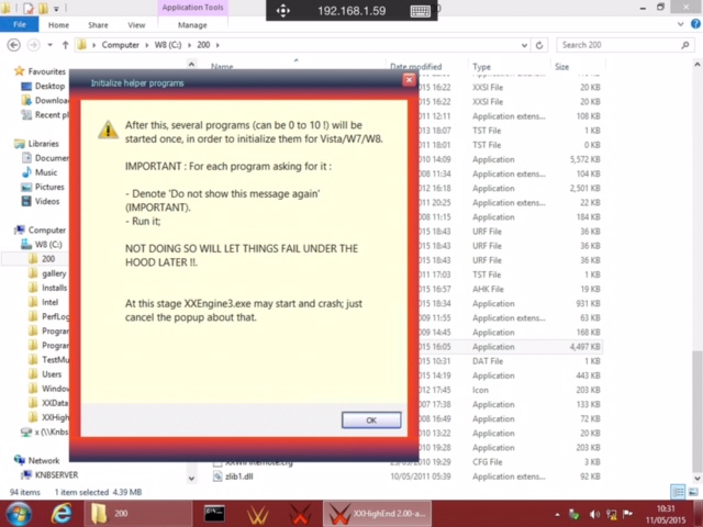

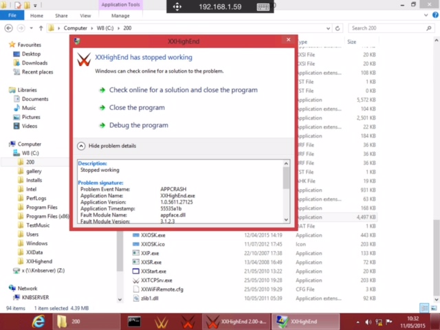

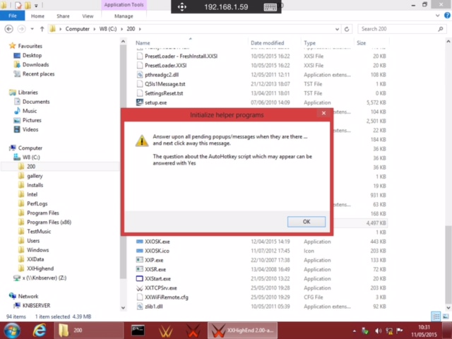

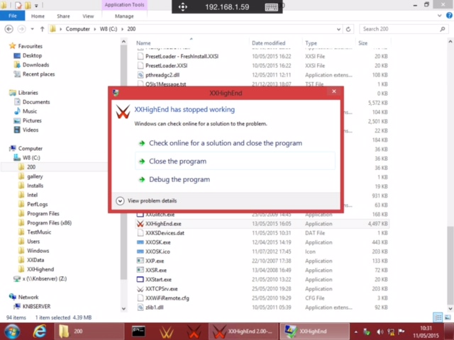

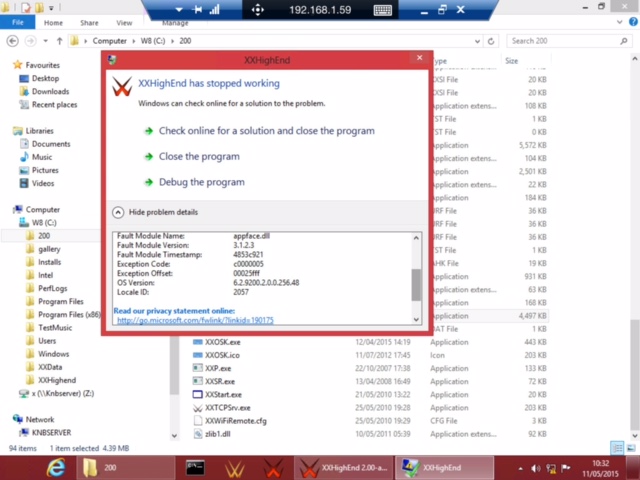

Screen shot during start attempt of 2.00

« Reply #6 on: May 19, 2015, 11:17:48 am »
Thanks !
What if this is related to you doing this via a Remote ?
Can you try it in direct fashion ?
