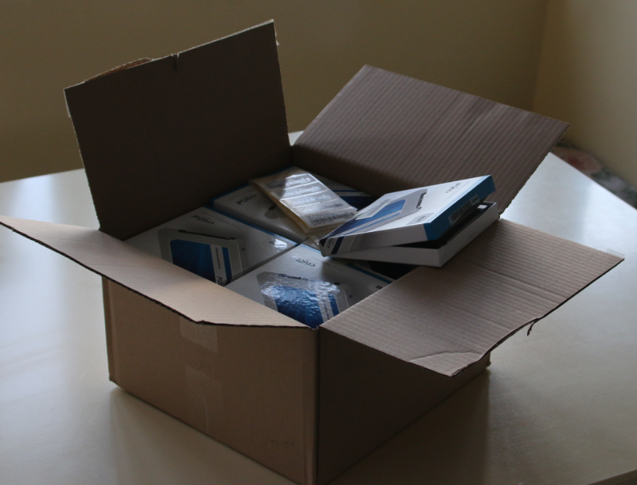

I am starting to get a little nervous ...
Envision - It takes about 90 minutes to prepare one SSD (all starting with a clone from a base SSD). But I can forget so many things and I can do so many things wrong. It really starts to occur to me only now that I/we never did such a thing and that whatever I forget is for you to deal with. Maybe that isn't all so bad, but what if I am actually finished and only then find out that all the SSDs fail something. So what then ? change all XX in uncountable hours ? re-clone etc. all XX in XX times 90 minutes ? swoon
Part of what's there to do is not even really known to me. For example, how to really clear all what I have been using myself ? Normally (e.g.) XXHighEnd freshly installs or anticipates *your* old situation. Now it is just mine ...
Just to give you an idea, this is what I woke up with today. My ToDo for it all :
Make all the PC Names the same for each OS.
Change all "PeterSt" workgroup to the default "Workgroup" for each OS.
Upgrade the 10565 TRIAL to 10586.0.
Activate all XXHighEnd's in all OSes.
Put all OSes in Normal OS Mode (needed to let install your devices).
Put the latest XXHighEnd (2.05) in all OSes.
Install the 1.04 NOS1 Driver version everywhere.
Cause the Driver103.tss to exist everywhere (not the .tst).
Set the date "properly" everywhere.
Check XXHighEnd settings for general acceptance (e.g. not that there's a too low SFS for general purpose).
Clear the Playlist Area everywhere.
Somehow clear the Favourites and everything like Gallery data in all OSes.
Clear the XXHighEnd Logs in each OS.
Remove the Drive Mappings I use myself.
More ??
Clone the SSD.
Apply the necessary "repairs" after cloning.
It would be best if I aplogise in advance for all what I may forget and what you thus have to do individually (of course with guidance).

« Reply #50 on: January 14, 2016, 12:05:20 pm »
heat Time for a break here heat
I planned to ship the whole lot today, but I'm afraid it will be zero of 'm. No, I am sure. swoon
Apart from other issues I wasted the whole of yesterday on, today all I have been doing is rebooting. 4 hours of it;
I now ran into a problem of which I don't know how many more boots and copying and what not it requires - before I am sure there really is an unsolvable problem. But it looks like it. Look :
First there's the nasty habit of 10586.0 regularly losing RDC connection, the only solution being a reboot. Yesterday I was a bit fed up with that and thought to boot into 10565 (RAM).
That suddenly appeared to be XXHighEnd-deactivated. Huh !?
So I went back again to 10586.0 and luckily (for my mood) experienced no further problems there.
This morning I started investigating that 10565 activation problem, wanted to look into some log files but was told that the TemporaryData folder was inaccessible because corrupt.
WTF !
XXHighEnd would not start anymore either and the boot file is then marked as corrupt by Windows. So, can not boot into it any more. But, easy to copy back a backup file of it.
30 boots or so and several OS copying activities later, it is definitive : The SSD can not cope with something. The "what" is not clear yet, but the least I should tell you guys is that we must expect that the whole pile of SSDs need to go back to the supplier and be exchanged for HDDs.
Possibly that also solves the 10586.0 disconnecting problem, because it is since the SSD that I have that issue.
Anyway ... this is NOT funny because of the throughput time it takes. Actually I am considering driving 350 Km or so to exchange the lot because otherwise I feel I won't have all in a week of time (RMA must be aproved, must possibly pay for all the HDDs first while the SSDs won't be credited - thus this must all be arranged for "in advance").
So what's happening is that as soon as I try to access the TemporaryDatafolder in 10565 of the SSD, that OS gets corrupt and can't be repaired (that I have seen, so far).
Copying a backup to the SSD lets happen the exact same, as if the base backup file was not right after cloning to the SSD. Copying from the original HDD implied the same again, and finally I checked the same "procedure" when booting from the HDD and there all was fine.
So it really is something with the SSD. Possibly it is about MinOS and while 30 minutes ago I thought to check that, I already saw several copy activitities coming, because how to get to Normal OS when the OS itself is corrupted. So do that in the HDD, copy that file of it to the SSD and then ...
Yea, then what ? I don't even want to know and rather started typing in here ...
Strange thing is that this only happens to 10565. But before someone says "never mind 10565 then" ... no. This can not be trusted now.

« Reply #53 on: January 14, 2016, 12:52:20 pm »
Anthony, yeah, I am now looking into possible 10565-SSD problems (Google). So if *that* would come forward ...
But the whole siituation is so specific that I have no hope to find anything. Or maybe a little hope, because operating systems sure treat SSDs in a specific fashion (about deleting and the TRIM feature and maybe more).
Btw I forgot to tell : the exact same happens with two of those same SSDs.
Just thinking ... I have another brand laying around which I could check too. But time time time ...

« Reply #58 on: January 14, 2016, 02:35:39 pm »
Well ...
I see it is 1.5 hours later now before I managed to do that.
Advantage : I had to try the "upgrade with a new OS" for real and found that I forgot something somewhere (it is really quite crazy how many permutations exist of "being" in an OS type (hdd/ssd, file, RAM) and creating a type (file, RAM)).
But on to the result :
On this other SSD 10565 just works fine.
I'm afraid it won't tell all because this other SSD is smaller (64GB) and I can't put all the OSes on it. I mean, the error on the other SSD (brand) can be related to the coincidental physical layout (both were cloned from the hdd in the exact same fashion).
The only thing I can say is that it won't be 10565 and SSDs in general. But at least I have a better reason to dump these SSDs back to the supplier.
« Reply #59 on: January 14, 2016, 03:32:26 pm »
Better try a new ssd or hdd first. Meaning order just one. Will take more Time but less money and trouble.
