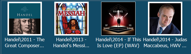

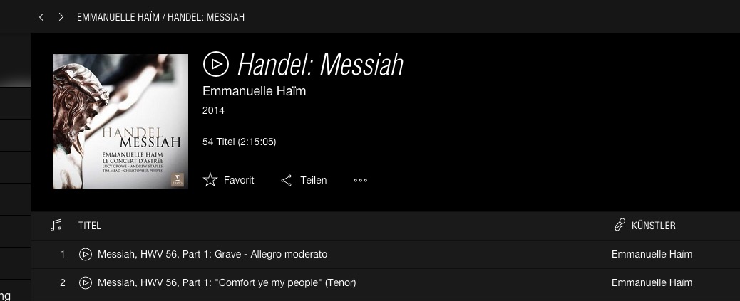

Hi Michael - Nasty example this is !
Well, it works, AFTER you know how they store it. And this IS a problem.
If you look at the "Artist part" of the Albums below, you can see what I looked for. But I could only do that after Tidal showed it to me first. See last picture for one of them. The other was different (just under Handel) ...

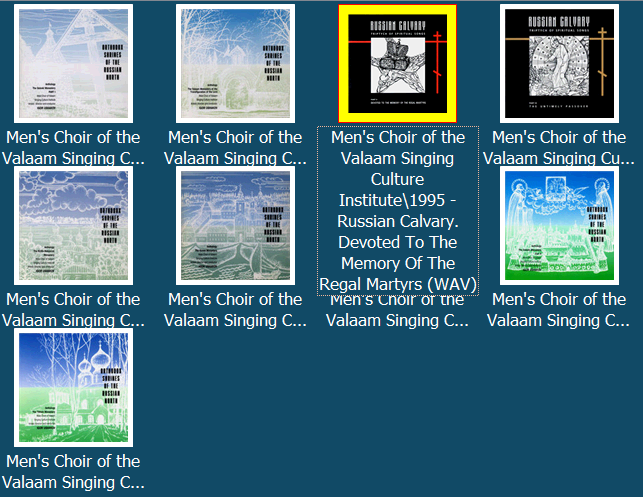

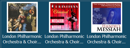

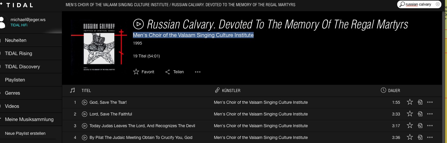

here is another one
This one i cannot prepare the streams.
The album is not downloaded.
Tidal issue?
Regards, Michael
« Reply #5 on: December 29, 2015, 08:57:02 am »
Michael,
ok.... Handel: Messiah did the trick.
No, ... I suppose you don't know how to do it ... Happy
The Artist is Emannuelle Haïm. Of course (and again) you must know that, but the Tidal program tells you.
Fill that (precisely !) in the Artist Name text field (in the Search screen) and then you get the below.

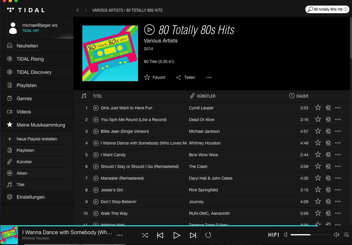

I have some more searching struggles. Here's a tough one I have no solution yet.
Compilations.
80 Totally 80s Hits
Various Artists
No solution found yet to have it appear in XXHighEnd.
Maybe there is a way to make the search feature in XXHighEnd more robust?
Meaning that when I enter a correct substring, the album would still appear.
But in my example there must be another reason. It is not showing up when I exactly enter the Album Title.
Any thoughts?
Michael
« Reply #8 on: December 29, 2015, 02:52:37 pm »
Yes, that one is too difficult for me too. Happy
I now see that I don't allow to search for Album Names only, and that is the problem here;
So combined with "Various Artists" as the Artist, this now "fails" on the number of result lines. So there are so many "Various Artists" albums that the list is truncated before yours surfaces.
I assume you mean INcorrect ...
Nah, because the same problem is implied as just described : you will get so many results that you won't be able to choose from it (plus that you wait forever until the result is there).
Inside information :
The problem is exactly the other way around than you'd expect - the standard means of Tidal to search for you (for a program like XXHighEnd) is that when you search for Deep Purple, it also comes up with Deep Forest and The Deep and whatever, and also Deep Purple. This already presents you a list where you can not choose from. It is thus *me* who makes the list shorter for you, by checking for the exactness. You would go crazy if I would not do that.
Also, there's so much more which doesn't work as you think or expect. Example : Genres. So you can search for Genres you thought ? Well, it would be the most helpful to now minimize the list, hence allowing more "wild card". But ... while Tidal shows you Genre search and think it works, it doesn't show you that maybe one out of 1000 (10000 ?) have a Genre filled in its registration. So what Tidal shows you is just nothing (of it all). Meanwhile, we can not use it at all, because it is just not registered.
Record label and (really) dozens of things (data) more, are all not registered. But they are provided ! ... empty. Such a waste / shame actually because all this data would help so much for searching.
Btw, this problem with the Various Artists should be solved when I allow to look for the Album Name only after all. But I did not allow it, so far, because that too can easily come up with much too much. I didn't try, but many could be named "under the moon" (for stupid example). But I can allow it and we'll see.

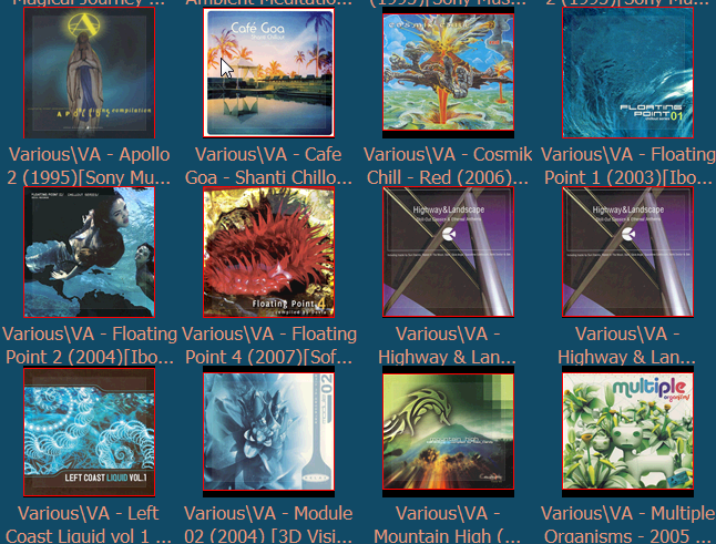

Something else : You are not going to tell me that you explicitly look for such an album, right ? (you wouldn't be aware that it exists). Still, I have many examples myself with Various Artists and I can't even think of where to begin for searching for them. See below - and I have 800 or so of these, all in the Genre Ambient. In Tidal I'm confident I can't even find one, OR I make it so that all of Various Artists are presented which will be a literal Million. And oh, I will be able to "sub search" that, but the point is that these million need to be downloaded first for their meta data. It is just too much ...
