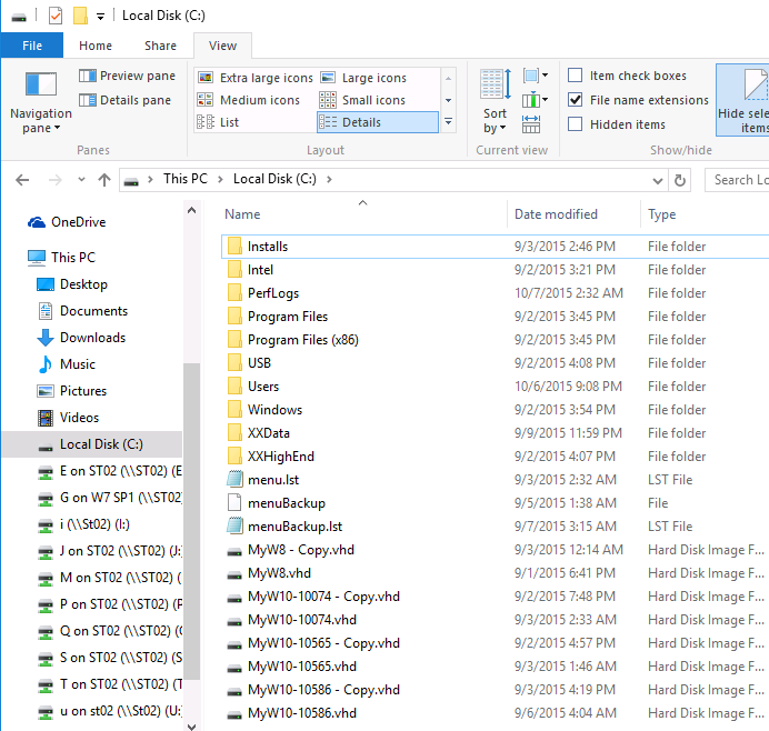

Let's first look at the situation that we booted from the TRIAL Operating System, which is the only normal OS in there. Thus, this is the only OS which has been installed in a means we are all used to. It only shows a Drive C: and nothing else for local Drives (assumed you did not connect any USB Flash drive etc.) :
(notice that in this example the E:, G:. i: etc. Drives are Network-attached volumes, specific to the situation of the screen shots (over here).
So we see a Drive C: and all the OS files are in there, in the root.

It has been said elsewhere, but only if your Explorer shows the situation as shown above, you can quite freely "manipulate" the files when needed (more about that in Tutorials elsewhere).

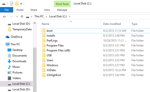

Now we are going to boot into one of the other OSes on the RAM-OS disk - and now we see this :
See it ?
Now Drive C: does not show the OS files any more. Actually this is a whole different Drive C: now; contents is different, all is different. It *Is* different.

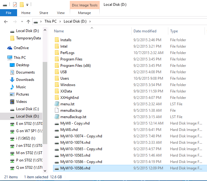

What we saw previously (first screen shot above) we now find on Drive D: :
Compare with the first screen shot and you will agree.
Now watch out : You will see the above under Drive D: only when you just booted. Meaning : regardless of whether this was a boot from a BASE OS or from a RAM OS, this works as long as the HDD is still in. But remove it and you will only see the Drive C: of the screen shot above the last one (but see more below how to re-attach that).
Envision that in this last screen shot situation we booted from MyW10-10586 BASE.
Rule :
Most probably you can do what you want with the highlighted file you see, but it is VERY WRONG to do so. This is because right at this moment the OS runs from that very file.
This is how the general strict rule should get to you that once you booted into one of the other OSes than TRIAL, you should stay veray far away from touching the OS files you see above; you could be running from one of them and things will go wrong badly.

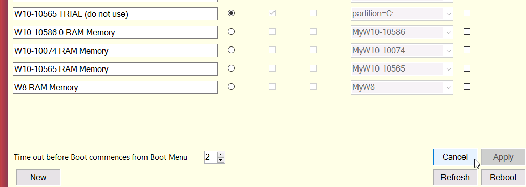

When you booted from a RAM OS (the Memory denoted ones) and you had the HDD removed from the system but want to put it back and "do something with it", then this applies :
1. Put it back in;
2. Start XXHighEnd and RightClick the Stop Button;
3. Choose Boot Into;
4. Press Cancel in there.
This will have caused the HDD to be mounted again and now you will see the Drive D: and you can access it.
There are more means which will automatically mount the RAM-OS HDD, but this is the simplest means without hassle.

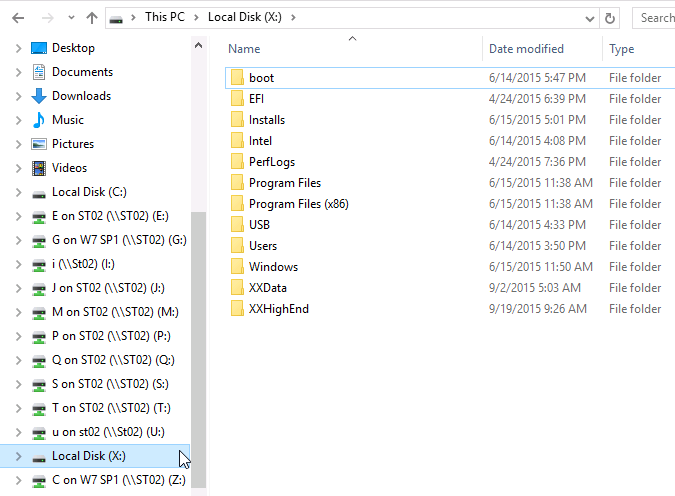

Now on to "attaching" to one of the OSes, while being in another ...
Attaching : Connect to an Operating System File which thus contains a full Operating System and which you normally view from a Drive C: and which you now can view from another Drive Letter.
For us, this Drive Letter is always X:
The below assumes that we booted into TRIAL and that *thus* (think about this) the OS Files reside on C:.

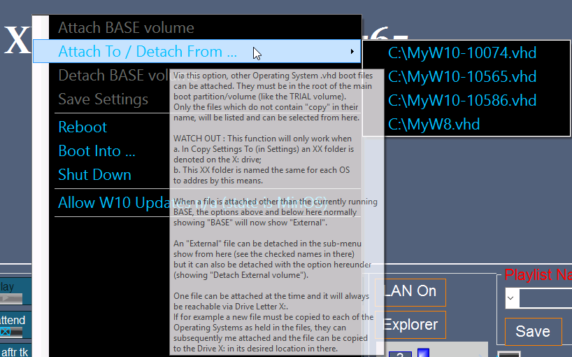

Go to the Stop Button, RichtClick it :
... and choose one of the OSes shown in the sub menu at the right hand side.
Assumed we picked MyW10-10074 and this shows for result :
... we now have 10074 under our finger tips in Drive X: :

Prerequisite #3 :
Drive X: is reserved for XXHighEnd and it is not allowed to have any other device allocated to Drive X: at any time.
If this happens after all, your settings will not be saved to permanent storage, when you shut down or reboot. Thus :

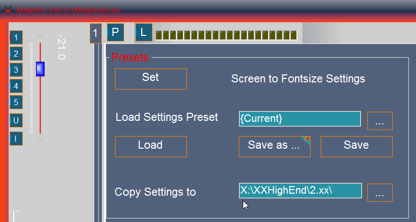

What we just performed explicitly, is performed internally exactly the same when your Settings need to be saved. That is, when the next is applied as well :
See the X: above the Mouse Pointer;
It is that Drive Letter which is used to Save Settings and which is no different from what you might be using already when using a RAM Disk (which RAM Disk is not the same at all as using the OS booted from RAM).

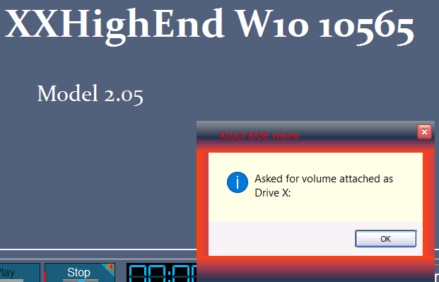

One last thing to watch out for :
If that X: shown in the last screen shot is a C: or something else, then STILL when you attach to another Operating System File (like we just did) that message "Asked for volume attached as Drive X:" appears. But now it is not for real and you can see it by the X: Drive not appearing in Explorer.
Read : If you can't find the X: Drive, the "Copy Settings to" field will not contain the X:. And :
This is the most correct for the TRIAL Operating System (it has no "external Permanent Storage" and "it can not boot from RAM".

Any Operating System that can be booted from RAM and which is about the BASE OSes you see in the Boot Menu, *NEEDS* to save to Drive X: and its XX folder as shown in the last screen shot.

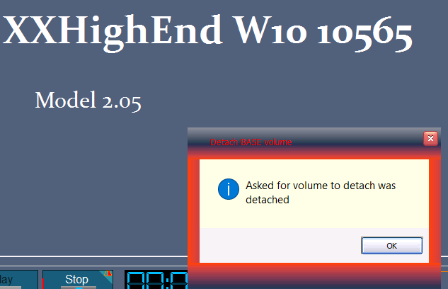

N.b.: Detaching a previously explicitly attached OS is necessary because it implies "flusing" of the applied data; it is the same as we "eject" an USB drive etc.
The situations which imply automatic attaching will also (under the hood) automatically detach. However, when we attached explicitly ourselves like what we did above as our last exercise, requires explicit detaching just the same :
See at the mouse pointer and also notice the check mark in the left hand side of that menu (indicating that that OS file is now attached). Clicking that option and this should occur :
... and now you can remove the HDD from the system, if you like.
