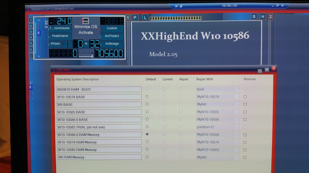

Peter, no idea why in the XXHE v. 2.05 when booting from the RAM-OS into e.g. 10586.vhd or vhd RAM the title stay always the same: XXHighEnd 2.05 (C:\XXHighEnd\2.xx)
What perhaps mistakenly did was restart from the ram without placing back the RAM-OS hdd.
I´m sure that I´m playing from the ram because I can pull out the RAM-OS hdd and use XXHE without problem but, is there something wrong?

« Reply #1 on: May 09, 2016, 03:14:47 pm »
Hi Juan,
Nice trick ! but I just tried it over here and it doesn't want to boot (so remove RAM OS Disk and Reboot -> nothing but which can be done with some other trickery, I think !).
Yesterday I tricked the lot the other way around : I thought I was booting from RAM, removed the RAM OS Disk, after which it went awfully silent ... (so indeed that doesn't work, although it works for a minute or so).
It has to be so that you have an OS on one of your music disks. Can it be that ?

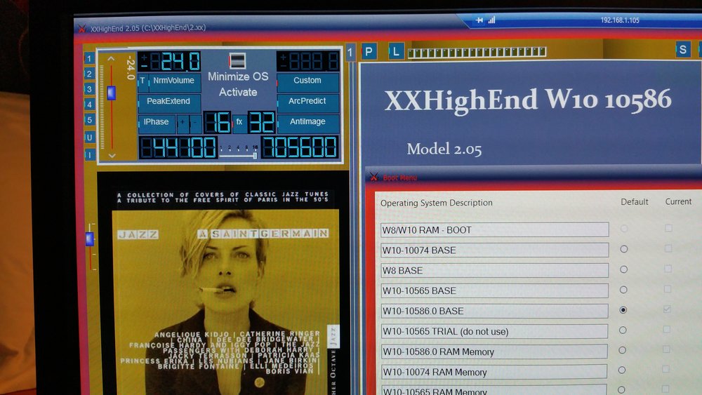

« Reply #3 on: May 09, 2016, 04:39:01 pm »
Peter, I can do absolutely the same as before. That is, I can load any system in the ram and remove the RAM-OS and everything works properly in the Audio Pc. The only difference I can see is that in the title bar always appears the same. Here I put another picture, in this case with the 10586.0 BASE. As you can see the title is again XXHighEnd 2.05 (C:\XXHighEnd\2.xx), the same one as the previous picture.
Yes, there´s another W10, the one I use in the Music Server Pc, it is in a partition of one SSD where I also had Tidal and XXHE 2.04 and 2.05. Now I´m not using Tidal anymore but the Tidal structure and XXHE versions are still there.

« Reply #4 on: May 09, 2016, 05:01:14 pm »
Juan,
Can you confirm :
a. You can get it all right again (so no problem in the end);
b. You can repeatedly reboot without the RAM OS Disk in there.
Ad b.
I wonder : How do you know that it actually reboots ?
So if you connect a monitor to the Audio PC, you may see unexpected things ...
« Reply #5 on: May 09, 2016, 05:33:22 pm »

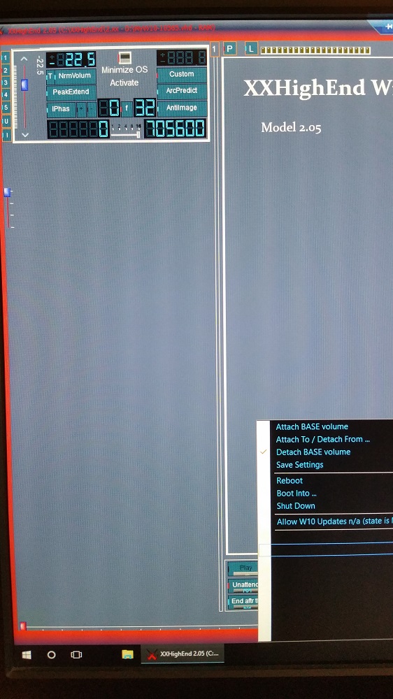

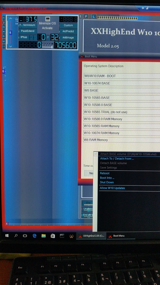

Hi Peter, I think that the problema has to do with attach/dettach 10586.0
As you can see I can Detach the 10565.0 volume but not the 10586.0. I don´t know what I did wrong nor how to fix it up.
« Reply #11 on: May 10, 2016, 05:57:38 pm »
I can stare at this forever, but I don't see what it can be.
Let's hop over to email.
