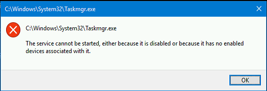

So - also for everybody who tried to help Tore - just nothing runs any more. Not even TaskManager.
UAC was probably still right, but the internal (OS) programs to check it, could not run. Same like Regedit to change it could not start (see posts about that).
So the sad thing is that all was solved by copying back that "10586 Copy" version. 5 minutes of work (of waiting actually). But that did not happen and now the whole lot is over here at us, just to notice this ...
Hi All,
The same now happened to myself. But this is not correct (sort of) :
Summarized what will have happened :
1. PC got hooked up to the Internet (Tore will no the Why of that, but it should not have happened);
2. W10 Updates were downloaded by the OS;
3. The OS got into the state of "OK, I am going to update myself";
4. ... which probably miserably failed because of the MinOS state (but this is just guessing).
What I did to get into this state, is this :
Moved up the UAC (User Account Control) slider with one step and rebooted.
By coincidence (I was testing something) the check in XXHighEnd for that UAC level was not active, but I don't think this is related. Well, I could start XXHighEnd because of it, but received unexpected errors anyway. And, after setting back the normal UAC checks, it appeared all the same as Tore experienced (and which I saw over here from his RAM-OS Disk).
Back then I was sorry that I did not sort it out (how to recover from this) but now, 60 minutes later, I can see that there's no solution to it. Too few things will run and what I get from it is that "Run as administrator" won't run any more. So all what requires Adinistrator (elevated) rights, just fails.
I also changed something with gpedit, but I can't imagine that this is the cause, just because Tore will not have done similar by far. Thus :
I think it is so that once you slide up the UAC by one step and boot into that, some inconsistent situation occurs with Rights and it can not be repaired because all what you do requires those rights. Next guess is that something like that happened with Tore, or by him changing the UAC slider, or because the Windows Update does that. That Windows Update does this, seems logic to me. But anyway the real culprit will be the slider position.
Now I am going to look for my own 14393.0 backup ...

« Reply #43 on: November 05, 2016, 06:34:55 pm »
Indeed it is that simple ...
Be in MinOS, slide up the UAC, Reboot by means of Windows itself (not by means of XXHighEnd when it is to be started first, because it will repair right away) and find yourself locked out.
I tried the same in Normal OS but there all keeps on working.
On a side note : in 14393.0 it will not be so easy to let this fail, because rebooting by means of the Start Button most probably won't work (because the Start Button does not work). So you really need to be "lucky" to run into this failure.
And as said, Windows Update probably will reset the UAC as well (for itself) so run into Windows Updates in MinOS and you're dead.
PS: If you start XXHighEnd in this erroneous situation and it comes up with the dreaded UAC Reboot message and that a reboot is needed or else XXHighEnd will quit, the below shows when you click away the Reboot message, when the problem is a fact (the number in that Temp name will be different).
