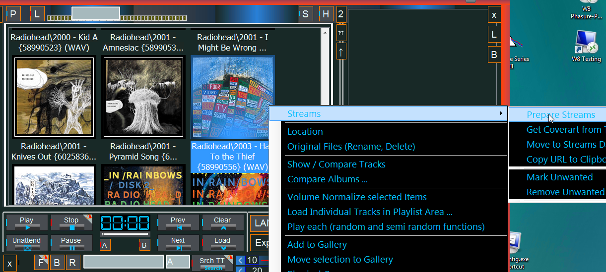

But I do have a minor question regarding preparing streams. When I select an album to be prepared, only one of the tracks in album will be prepared. How to prepare the whole album? My current workaround is to play whole album in unattended mode. Once it read all tracks are read by XXHE, they are all prepared even without playing through all tracks in album.
Also is there a way to resume a partially prepared alubum other than deleting everything and starting afresh?
« Reply #37 on: March 15, 2018, 06:19:08 pm »
I assume you want this because of that other issue :
... and when this is solved you won't need to Prepare a remainder, right ? OK :
I actually am not sure what you mean. There is no way to Prepare an album partly only, unless you just play one track of it in Attended Mode. But well, let's say that you may be doing something which is not expected by me. So what I do myself :
- Search for the album in Tidal;
- Prepare it;
- Play it now or later.
There's no way that you will end up with a halfly Prepared album unless something goes wrong during the process. And then still :
When the Prepare stage is interrupted (which is similar to Prepare one track only) then if you'd Prepare it the next time in full, it will Prepare the remainder. Mind you, this is all done in the "TT" structure (see Search button encryption) amd when done, Move that to the Tidal structure (again see Search Button). Thus, it is *not* the intention that you apply this Move when you have Prepared one (or a few) tracks only. I am not sure what would happen, but I am quite sure unexpected things will happen just because I did not make it to behave like that. unsure
I think that there's one means to Prepare an album only partly : Play a track of it while the album was not prepated explicitly. So be sure you understand where that Explicit Prepare sits, look below (Library Area is active there).
You can still do that after you have played on track before explicit Prepare, but don't move to the Tidal structure first.
Let me know if you understand anything of this post because I feel we may not be talking about the same things. This is also related to this :
I understand that. But what happens in that case is that you play the tracks subsequently (but in one go) which causes XXHighEnd to subsequently decode them. This wasn't even explicitly made like/for that but I can imagine it works (but maybe things go wrong when you don't play the whole album like this, and the next time it finds an inconsistent situation and causes you to do all over in order to get it right.
So the more I think about it, the more I feel that you do not use the option I show below. And notice that you can do a 100 at the same time, if you want (just select more and then perform the Prepare function).
Lastly do notice that this Preparing is unrelated to the MQA decoding. That always happens in real time; ot per track when paying Attendedly, or for the whole album in parallel when you use Unattended and per as many in parallel as you have processor cores.
I think what you imply by your means of playback (which starts with dragging in the UNPrepared tracks) is that per track the track will be Prepared and MQA Decoded after each other and that again in parallel when done in Unattended Mode.
No, I certainly did not make that, but I can imagine that it works (to some degree). Happy
