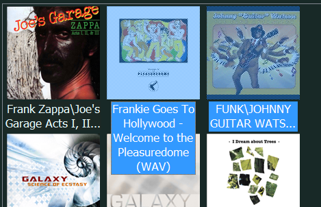

  • A cool new feature for those who use the Library Area ( [ L ] button in the top) and select albums from there : subsequently selected albums in the Library Area appear in that sequence in the Playlist Area. Notice that the real value of this comes forward when the (selected) Items in the Library Area are Demo folder Items and you so can select groups of "demo tracks" by means of tapping (clicking) around in the Library Area - that finishing off with pressing Load, and see the groups of tracks appear in the Playlist Area in the sequence of you tapping the Items. Example :
    Here (left) firstly the Johnny Guitar Watson album was clicked.
    Then (right) the Frankie Goes to Hollywood album was clicked.
    Now we press load and :
    we see that the Johnny Guitar Watson tracks appear first, and the Franky goes to Hollywood tracks appear after that.

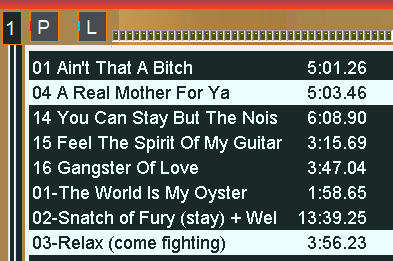

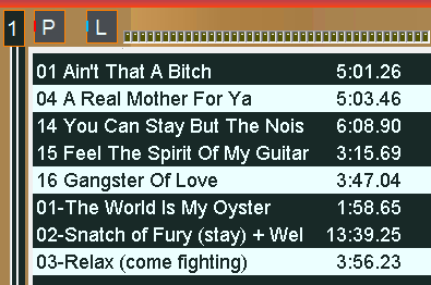

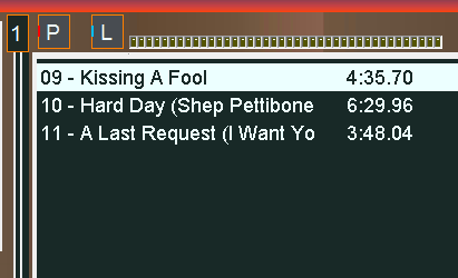

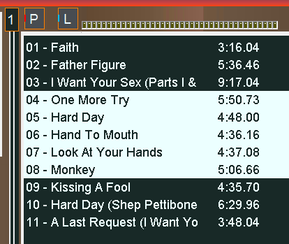

  • Proceeding on the above, we can similarly select the tracks to play from the Playlist Area, and these they will be played in the sequece we selected them.
    Above again from left to right what we selected. But now watch the implemenation if this; here's what the Playlist Area looks like when we now press Play :
    ... and what we did not select previously just disappeared.

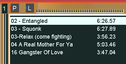

    From here we can add more tracks with the notice that by no means it is mandatory to use the Library Area (see previous topic) fo fill the Playlist Area and select the sequence of playback of the tracks. Anyway we can keep on adding tracks *and* select them for the sequence of playback.
    A few tracks (from e Genesis album) were added here :

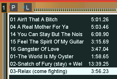

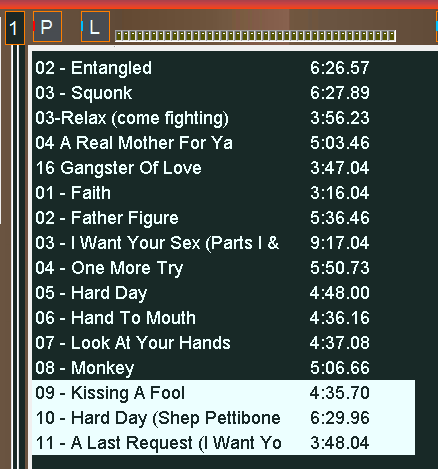

    but when I see it I decide to play the two Genesis tracks first and use the same means of sequence of selection as just explained :
    Do notice that first unselecting all is usually convenient, and the quickest way to do that is click the [ P ] button in the top (with the Playlist Area already active).
    This summarized : we've done away with the akward(ish) dragging in order to organize the sequence of tracks to play.

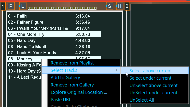

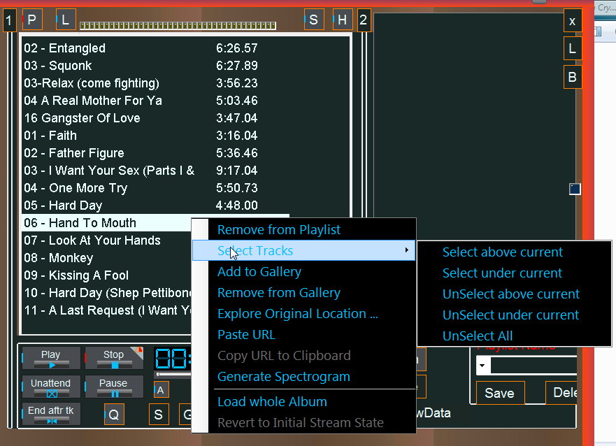

  • There is new context menu at rightclick of Library Items :
    In the line of the other new features with the play sequence, we can also now easily select or remove tracks from of a selected track. So suppose we want to apply some function on all the tracks from of the George Michael Hand to Mouth track, downwards, we choose the "Select under current" option which will give us this :
    Obviously if we now press Play, only these tracks will remain in the Playlist Area, ready to play or further manipulation, or, if we'd choose for "Remove from Playlist" (see first choice in the context menu) they will be removed.
    Here's another application of these new functions :
    Here we rightclicked on the Monkey track, and if we now choose "Unselect above current", all tracks (though including the current one) are Unselected, leaving the remaining selected tracks :
    and of course when we now press Play, this is all what remains :

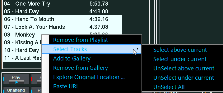

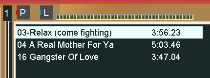

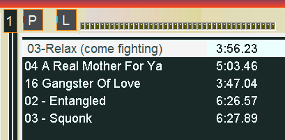

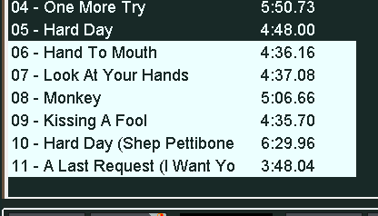

    Then there's this convenient just different option :
    Notice the two selected tracks, and the choice applied. This is what will come from it :
    Please notice that these means of selection are certainly not Windows-standard and were relatively complicated to make. Obviously this is all to the benefit of touch control and how to conveniently do what a mouse in combination with keyboard keys (like shift and control) would do otherwise.

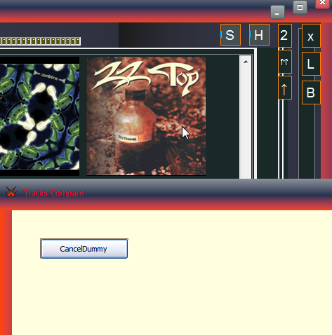

  • Watch out : In consistency with the above new features all had so be made so that an "isolated" RightClick on a Library Item now does not select the Item (previously it did). You can see this (not) happening by means of the background of the Item not being "greyed" and a "nothing happening" when proceeding with whatever is chosen under the RightClick. To test/practice this : RightClick on an Item and chose Show/Compare Tracks. You will see that an empty screen with a mysterious CancelDummy button shows, instead of the contents of an album (Library Item) :
    Notice that no Item shows the selected-colour (while the right-most ZZ Top Item was RightClicked).
    The credo : first Normal-Click (or tap) an Item before it can do anything with RightClick.

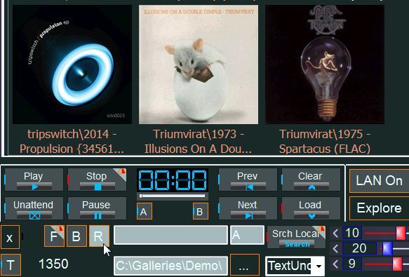

  • Speaking of which ... The appearing individual grids from Show/Compare Tracks showing the contents per selected Library Item, now also appear in the sequence of Selecting (tapping) them.
    Here the right hand one was clicked first, then the middle one and then the left hand one. After this, RightClick and Show/Cmpare Tracks, and now the sequence of selection pops up.
    On a side note, notice that you can randomly click in either grid for obtainment of Tracks in the Playlist Area anyway (and then Play them of course) and that respecting the sequence of this particular means of selection already worked (for ages). So the point here is about your recognition that your selecting in the Library Area and which you will very well know for the sequence as such, results in the same order of Items (albums) then you just selected. The value of this may be more apparent if you regularly use the [ R ](andomize) button to obtain a viewport on the Library Area which is always different.
    So that [ R ] button.

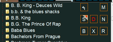

  • When one of the "toggle" buttons is used from the menu in the left pane :
    the Result List appearing in the Library Area now starts at a random Item in that Result List. It is the idea that you're more motivated to "for once play something else" and besides that will not be confronted with always the same "faces" which appear at the start of the List (which could be annoying).
  • The latter new feature implies a kind of "toggle" between positions in the Result List, when a same toggle button is used subsequently. Thus, would we use the [ D ] (Demo Gallery) button we'd go to a random first Item when we use that button a first time, using it a second time another Item will be implied at the top of the List but using it one more time again will show the same Item on top as the first time. And so on.
    This is reset when another toggle button is used (like [ N ]) but with that other button the same thing will occur at subsequent usage.
  • Annoying right-left movement of beforementioned menu when the buttons were used, has now been eliminated.

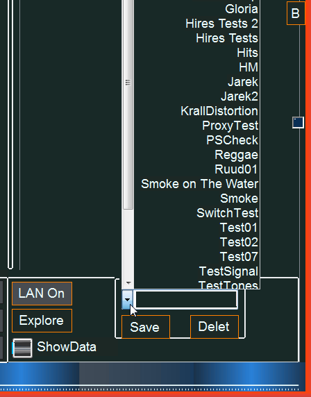

  • With the notice that in XXHighEnd a Playlist as such is a saved copy of the contents of the Playist Area (which copy can be restored to the Playlist Area) : A Playlist can now be added to existing contents of the Playlist Area; previously a Playlist could only be loaded when first the Playlist Area was emptied.
  • The selection of a Playlist goes by means of where you see the mouse arrow below :
    and nothing changed about that. What changed though is that a scrollbar now shows and thus the number of saved Playlist can be significantly larger than previously (because they can be utilized).
    Also, typing a left part of a Playlist Name (this is actually typed in the boxt next to the mouse pointer you see above) scrolls into view the Playlists starting with that left part of the name.

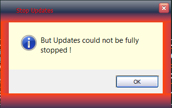

    When we attempt to stop Windows Updates (RightClick on Stop etc.), a message will appear telling you that Updates were stopped. However, when it is rejected and when entering the menu on the Stop button again, we will still see the option to Stop Updates; Apparently is failed.
    We can see it failing right away when after the attempt a second message appears :
