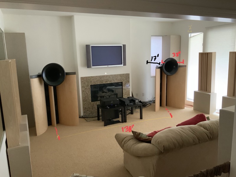

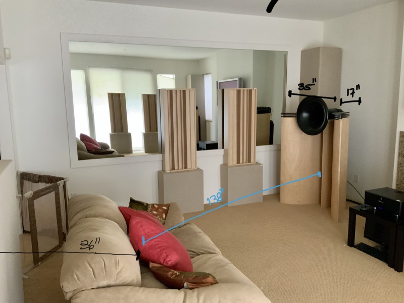

Hi Ramesh,
I have reached a good sweet spot for all genre of music, classical (and ambient  Wink )sound exceptionally great.  The side-wall treatments are very helpful in widening the sound stage, and reducing room noise. The bass traps in the corners behind the speakers have a component to tackle flutter echos. Bass traps behind the listening couch were to be mounted on the wall, but it works reasonably well on the ground. Not much toe in as you can see. With the right recordings one can have the illusion of music from behind the listening position as well. Considering the speakers act as point source, vertical soundstage is possible.
The horns generate a lot of energy... and acoustic treatments will do radical changes in its presentation. I.e. this is important for classical music where in there are numerous instruments, and smearing can have a domino effect.
Mine are typically all “red” for the FM curves, in the current room it works fine, I do try others every now and then, usually anything less, the spaciousness and image depth are affected.
This setup generates a soundscape that you are a part of (immersive), not just a plain figment of imagination, but as physical reality. Mostly to do with the bass, and how the system is able to let the entire harmonic structure of notes bloom into the room accurately. Bass is exceptionally clear! “Layered” square bass waves are appreciable, especially with ambient.
I have medium carpet and 9’ ceiling.
Pics can do the explanation.
I made them a little smaller so we can see them. If needed, I still have the large versions.
What's exceptional here is the "square" dimensions (138" x 138") - and then with reference to the toeing.
For the sweet spot (might I have any) I have it not that extreme but with the notice that I too have a couche where one can easily listen and now the dimensions are 240"(W) x 160(D)". No typo. This still works extremely well and the effect of crossing maybe 480" behind that listening position, doesn't do a thing that I notice. Imaging just remains and in fact it feels odd-ish that at such a close listening distance compared to the speaker distance all keeps on working (out).
IME this is toeing-out is crucial to the L/R bass not blending in a mush. So mind you (or you know already of course) the bass too is quite directional for these speakers (because of their "undistorted quality") and it just should not allow to add up (L+R) because else you challenge for the standing wave right in the middle hence you now *have* this sweet spot  "point" which IMO should be avoided. I know, this is quite contra-intuitive and against a few laws, but try it. And, each time I try to toe-in more, it doesn't last the session.
In my situation the bass is more profound and pronounced at 400" listening distance at the sides of the room there. This is not really reflections that I know of, and works out equally for both L/R sides. This is as if the middle beam (of a 240") cancels more (which is a bit like I just told about indirectly) with the suggestion that the beams on the sides add because of the side walls. It seems I can not prevent this BUT it largely depends on other factors like Q1 of XXHighEnd. Toeing in will help all right, but thus for the way worse. Possibly this is because of early (low frequency !) side wall reflections them crossing in your face.
Don't underestimate the power of the bass, combined with the again oddity that it is hard to extend that beyond the room (like towards neighbors or garden). Your stomach may ache because of direct impact while it dies out sooner than expected probably because you are "able to" not involve the walls (shaking).
Let me softly add that I am probably better off with bass traps, which btw I would not think of myself. But VJ has been over here and he not only tells about how vastly the sound quality improved in his room, but also that net his room is the better sounding (while dimensions are quite "impossible").
Btw, this visit was just prior to the creation of the Lush let alone the Lush^2 let alone the Blaxius^2, the Mach III and all that I forgot. Bass traps could be more expensive. Wink

Peter:
"IME this is toeing-out is crucial to the L/R bass not blending in a mush."
I believe you are right, this setup happened with some experimentation. In this position it all blended/locked in.
Ramesh:
Essentially this is a near field listening position. In fact, the FM curve selection may very well be as such. There is a 4-5 ft entrance on the side of the couch, which is continuity with stairs and hall, so there is some extra space for bass. For classical music, I would suggest moving the speakers wider (if you can), helps with imaging.
