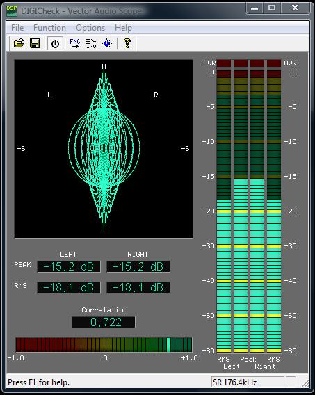

Have a look at these two images on the RME Vector Audio Scope. Guess which one is quad upsampled...
« Reply #6 on: March 09, 2008, 10:58:02 pm »
Wow. But I guess it's the one which says SR 176.4 KHz and is called Quad Upsampled.jpg. grazy
Uhhm ... does Double/Upsampled looks so as well ?
« Reply #7 on: March 09, 2008, 11:01:50 pm »
Yes, I realised the files names as I pressed post.

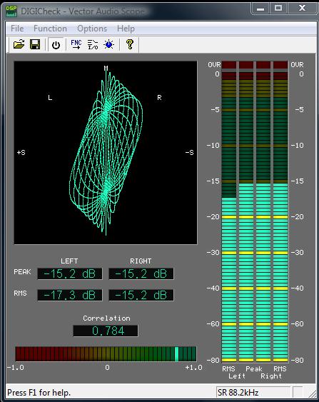

Here's another pretty picture...
« Reply #8 on: March 09, 2008, 11:04:27 pm »
Actually, my P70 transport is also capable of double and quad upsampling. But it's part of my other system. If I have time, I'll connect it's dig output to the RME and see what happens.
« Reply #9 on: March 09, 2008, 11:20:58 pm »
If your last pisture is, say, stable, then sure something is wrong there.
I'll dive into that this week. Something else for a change.
« Reply #10 on: March 10, 2008, 12:19:10 am »
Hahaha, not good. A clear case of program(er) error.
The Double-Upsampling part contains an error somewhere. The used bith depth can be the other way around just the same.
Smart ... swoon

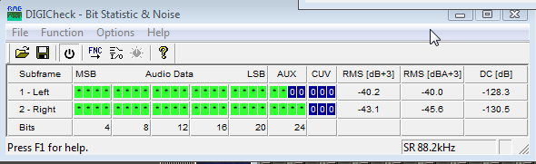

« Reply #12 on: March 10, 2008, 10:30:54 am »
Leo, they're not just pretty pictures. These things are taken very seriously in broadcast studios and in the post-pro and mastering field.
A Vector Audio Spectrum shows the level and phase differences between the left and right channel (often referred to as a Goniometer).
From the second you see the double upsampled image, you know something is wrong - it should be symmetrical when fed, as it was, a mono signal.
The quad upsampled image shows the effects of aliasing...
Hope this helps.
« Reply #13 on: March 10, 2008, 10:43:35 am »
Actually, thinking about it, the quad upsampled image suggested a 90 degree phase shift between left and right channels... I think.
Any other ideas anyone?
