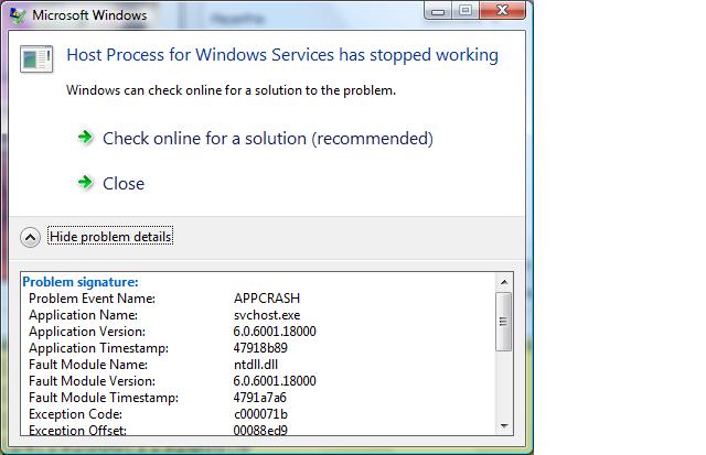

Also, when swapping between normal or upsample, the program crashes:

Re. the host error above:
Doesn't happen everytime, but also happens during playback, often after clicking next for the next song. Also sometimes happens without anybody doing anything.
This is not XX crashing, it is one of the sevices stopping. Did you never had that before ? Anyway, it's "normal". When this happens, click away the message and stop/start playing.
If it keeps on happening, change the priorities of the player.
If it can't be dealt with ... hmm ... then it must be you youreself ? hahaha but I don't expect that.
