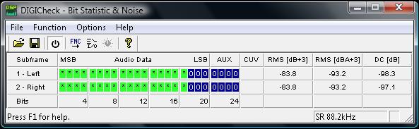

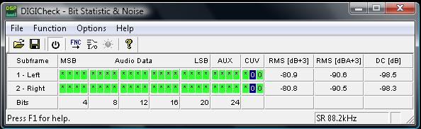

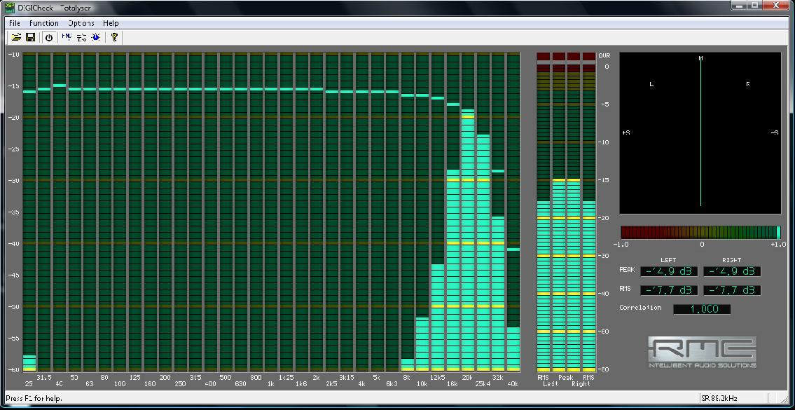

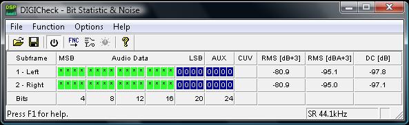

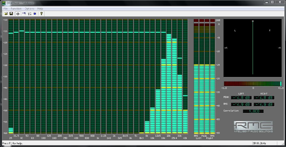

As I was using the RME, I couldn’t resist taking a few nice pics.
