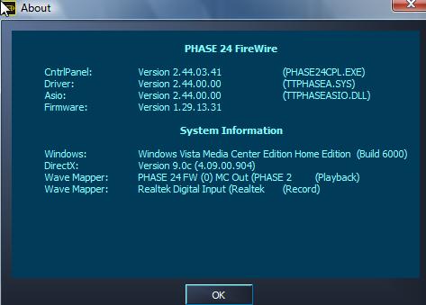

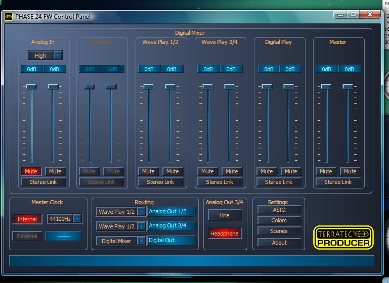

« Reply #27 on: June 04, 2008, 12:15:18 am »
Here they are:
