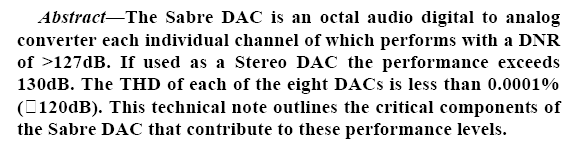

Ok, this is merely for fun;
Look at the description below. THD is less than 0.0001%. That is goooood for a DAC. But what does it actually say ?
The two pictures show the result (measured at the output of the DAC) of feeding the ESS Sabre DAC with a pure square wave. The first picture shows what's left of it at 3000Hz and the second shows a nice pure sine at 10000Hz. I talked about that earlier in this topic.
To me the second picture shows a 100% distortion. But hey, what I do here won't be a measurement of THD (http://en.wikipedia.org/wiki/Total_harmonic_distortion). Right, but what to do with THD if this is the real life result ?

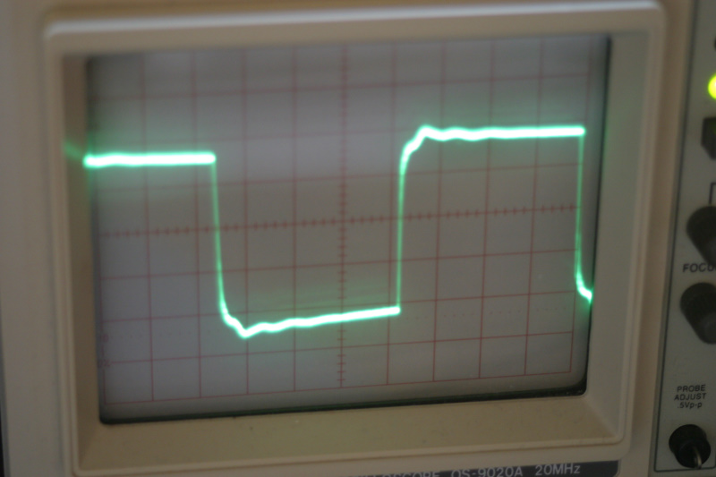

PS: The first picture below is the NOS1 filtered, and the second one filterless. Both at 22050 Hz this time. Not that this shows anything of the filtering itself (which would be about the frequency spectrum to pass through or not, although I tried 30000 Hz which shows the same; didn't try further), but there clearly is a difference electrically. I use filterless ... (which might change at decent A-B-ing later)
Dunno why there isn't any ringing with the filtered version, but as you can see the slopes of the squares aren't as steep.

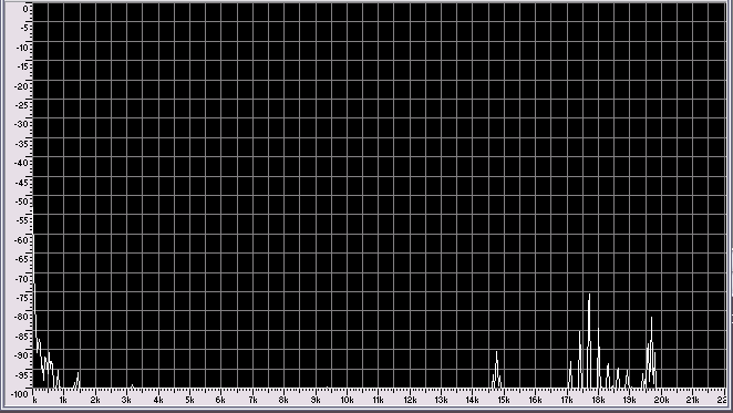

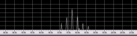

« Reply #66 on: December 28, 2008, 08:16:27 am »
I don't think I have a 17 khz tone
Be careful. Why would I think I have such a thing ? It is the pure coincidence that the NOS1 amplifies it, and after two weeks of not attenuating that (no preamp) I got crazy of something. I heard it was more noisy than it sould, but that is just white noise. It's not what got me crazy.
And then I got the glorious idea of measuring with a microphone and prove whether I maybe heard ghosts.
With the amplification of the NOS1, this goes to -60dB ...
