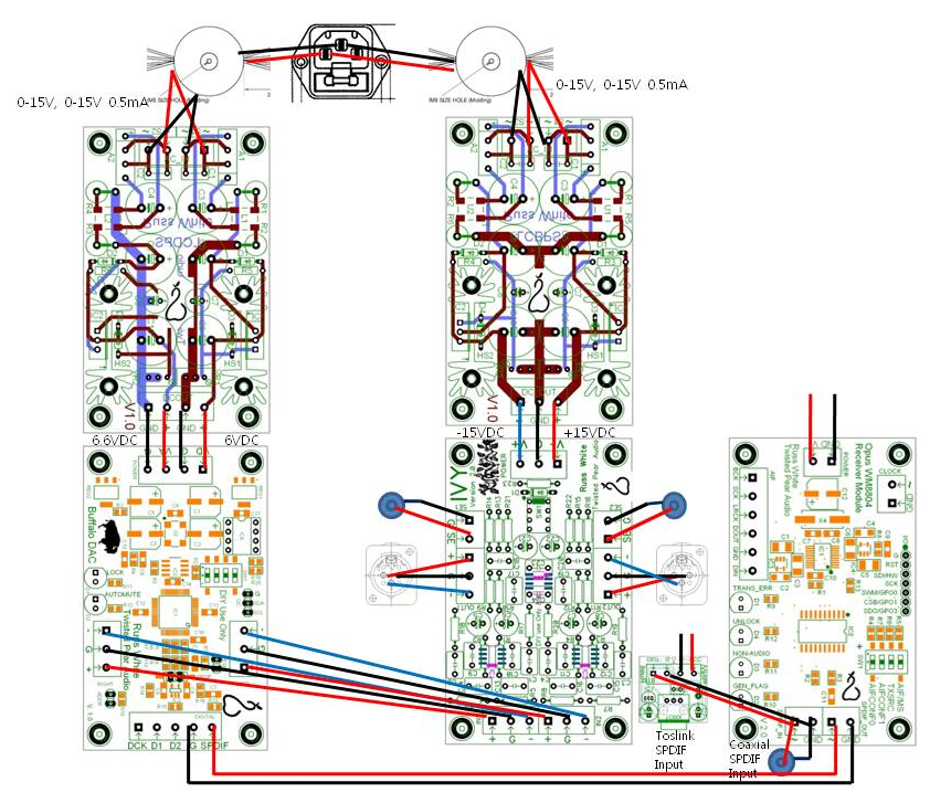

Hi Leif,
I'm not sure this is what you are looking for, but just in case ...
(mine is still in its packing, but careful, because I only need to solder the dac board really, and then I can hook it up ... but I'll wait for you first Happy ... and of course I have NO TIME ... wacko).

hello P
I know how to connect but I´m not sure I´ll make it in time.
Don´t you lack a common star ground in your drawing? to chassis even?
only difference in my place is that I will use Doede Douma´s USB pcb to start with and it needs a separate psu that´s almost completed.
Status:buff and ivy are connected together
psu´s  to BUFF and Ivy are not
x-formers to psu are connected and delivering
usb to Buff is not
ivy to output is not.
need a couple of hours more to complete.

Leif,
I don't think it is needed, and may even be unwanted (isn't all setup in "double" ?). And if you don't have a chassis, what to connect to then ? hehe
I think you'd connect ground from the wall to the chassis (and then sure not signal ground or whatever either !).
Note that overhere we're not all that difficult about proper grounding (for safety I mean now), which is very different to e.g. the US ...

[...] psu´s  to BUFF and Ivy are not [...]
Just be careful to measure the output V of the PSUs before connecting (+/-15V vs. 6.6 vs. 6.0).
Also, (I think !) do not test the IVY without the DAC hence load connected. If you want to test it without the DAC, ask Russ et al for the load hence what 5W etc. resistors to simulate the load with.
I hope you get it going !
