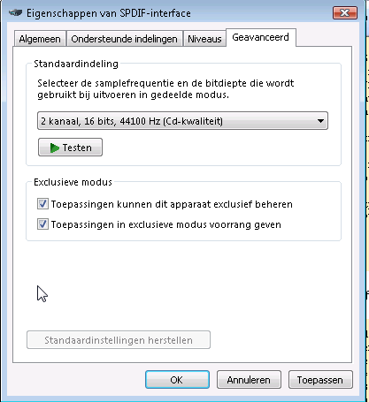

« Reply #12 on: June 18, 2007, 12:11:15 am »
And do you have both these checkboxes ticked for your sounddevice ?
(I didn't mention that before ...)
(and is that device your Primary Device ?)
