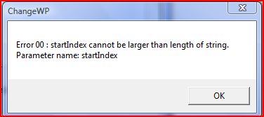

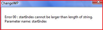

I am getting weird 'length' errors with latest version and any WAV file. (see attachment)
Seems to be related to spaces within filename (and/or folder name). If I rename the file to something simple e.g. 'test.wav' then error goes away.

Indeed the data in the second picture doesn't look right. Can you t ell me what is the "\Frank" part in there ? I mean, is it a folder or a file name ?
Then, do you say this did not happen at earlier versions ?
If so, are you a 100% sure you didn't mix files from an earlier install with the current one ? If you are not sure, please put a new install in a new folder and try again.
Of course, looking at this, other things are the matter. But that seems so unreal to me. You are using normal Vista ? And which Engine ?
If the above doesn't help, please switch on logging (Settings Area) and post the XX log file from the moment where it happens. If you are using Engine#3, please also post the X3 log file.
It was file name (Frank Sinatra - What's New.wav).

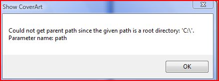

In the end, I had to delete files in Users/AppData/Local/Phasure folder and was able to get it running - However, the problem is still there... (notice also a new message in CaptureNewInstall1.jpg - I only get it when XX starts...). After clicking OK in all these eror dialogs playback goes OK until next file - then I get those 2 error messages again, and so on for every file.... the music however keeps on but you can imagine what my screen looks like after 20 songs (there are 40 error dialogs and they all need want to be clicked on....)
I've created a test case to make it easier for you: I put a single file in C:\TEMP and try to play it - I cannot see anything suspicious in log files but maybe you can....

First about that "could not get parent path" you're having now. This is about the files indeed being in a "one down" opposed to the root only, which should be "two down".
But, no problem here in the end.
