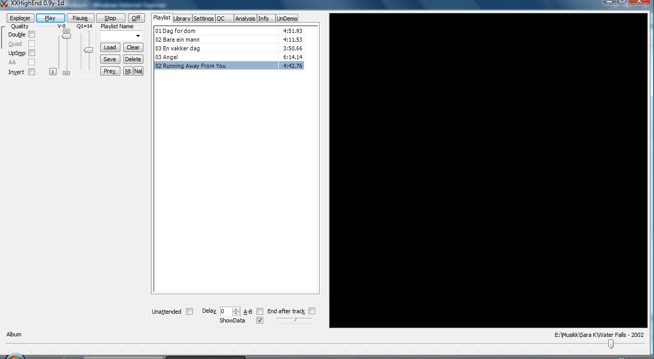

Hi folks!
Tried it now with the new 9y-1d version, placed 5 different songs from 3 diff. albums in a playlist and played them.
When the last song nears completion it plays audibly normal, but the track counter at the bottom stops about 10% from 100% but the track plays to the normal end as it should.
lol....
The counter also starts going away on each song BEFORE any sound emerges from that song. The counter is probably around 5% into the track when the song itself starts playing audibly.
« Reply #46 on: August 19, 2009, 07:00:01 am »
Yes, this has changed. Not completely intentional but due to technical reasons, and when I saw it I deciced that the old means was as strange.
When time permits I will see if I can make it all the way good (logical).
Thanks for the feedback !
