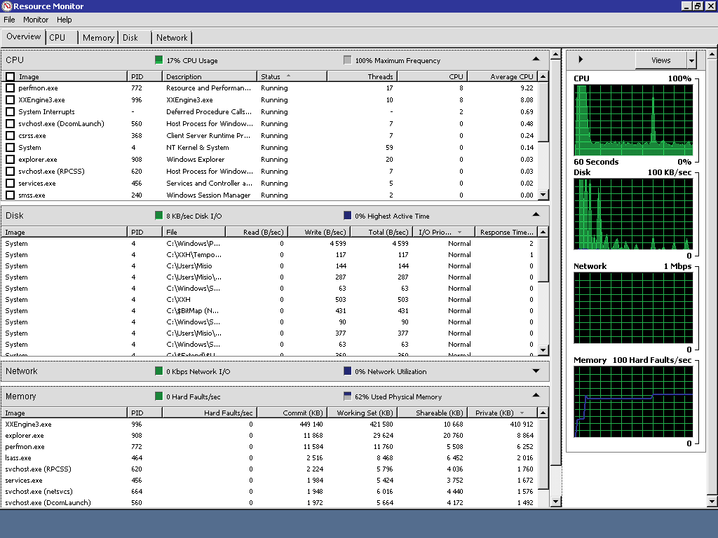

Peter, I did what you proposed and the results are following:
1) After reboot, I run XXHE and try to play 48kHz track upsampled to 192kHz with QAP. After few seconds of clicks and pops 'playback' stops with 'to many buffer errors'

Marcin, thank you. But I'm afraid I can't do much with it. Maybe you can imagine that when you show the bottom of an activity list you show the least important part. Besides you show it when the damage has been done (looking at the graphs, the time axis and (e.g.) "XXEngine3 has terminated").
Besides all, I don't think this will work anyway, because it is too dynamical. As I told (although wrongly yes, in terms of "deferred interrupts"), concentrate on "Deferred Procedure Calls". Or otherwise anything else as the cause for a differrent Graph. That is, if they are different in the first place. And notice that you can only start observing after playback (sound) has started.
Again, showing these pictures to me most probably won't help; you must interpret them yourself.
Ok, once you found what makes the difference, you can of course show *that*. But don't try to leave it up to me, because it can't work.
