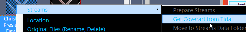

  • Tidal can now be used to download the Front Coverart picture/file for any random Album in your Library. Of course the Album must be available on Tidal. An example :
    Above : The two without picture are selected ...
    Rightclick (somewhere) and the menu you see above appears. Click the Get Coverart from Tidal.
    When done, we see that the picture in the right hand side is there now. The left one is not available on Tidal, so the cross remains.
    You can do this for all your Albums in one go but it must be done with some care;
    - Existing Front.jpg files will be overwritten.
    - Whether the Album is found on Tidal, depends largely on how well you named it yourself; Although some "intelligence" has been built in, at least the Artist Name must be spelled 100% the same as Tidal has it, or otherwise the Album just won't be found because of that.
    - It more rare cases it can happen that Tidal comes up with some general Picture of the Artist and thus now the front cover is wrong. In that case you can easily delete it again :

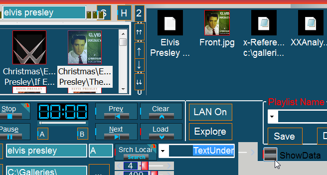

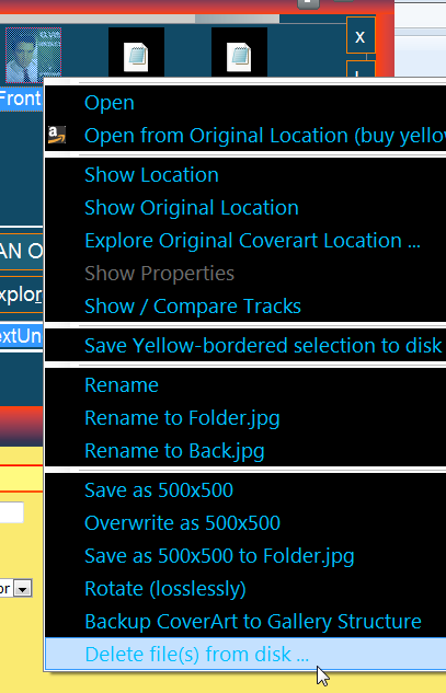

    Select it.
    Cause the Show Data button (right hand side at the cursor) to be active.
    Select the wrong Coverart file in there and RightClick it.
    Choose Delete File(s) from disk ...

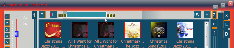

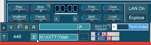

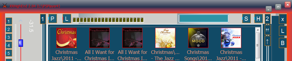

  • Look at this picture :
    At the mouse pointer you see an [ S ] button. Notice that at that position, previously there was a [ D ].

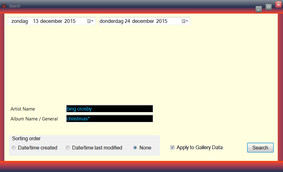

    When this button is clicked, a renewed Search Screen pops up :

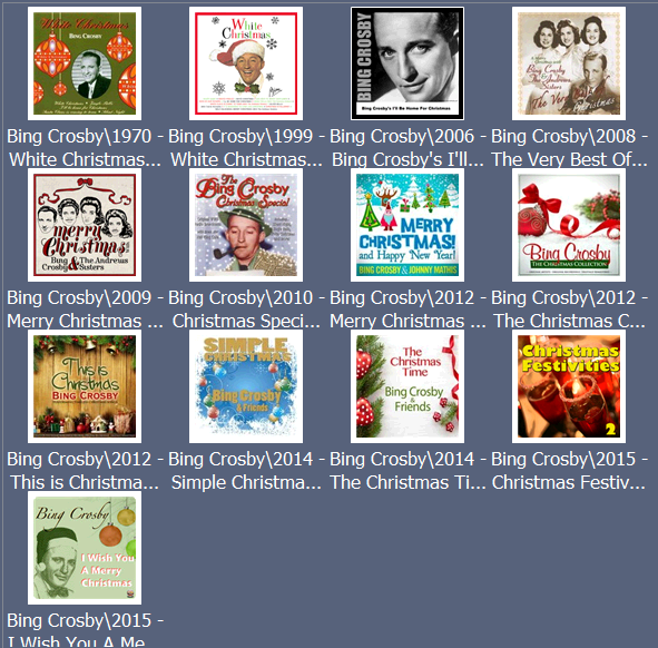

    Obviously we can enter an Artist Name and an Album Name in there. Either is optional and both are allowed to contain an * at any position to imply a wildcard. Do notice though that the position of the * doesn't do a thing. It is only that when it is in there somewhere, the result is going to contain anything with the words provided and those words being in the same sequence. Below you see an example with one word "Christmas" :

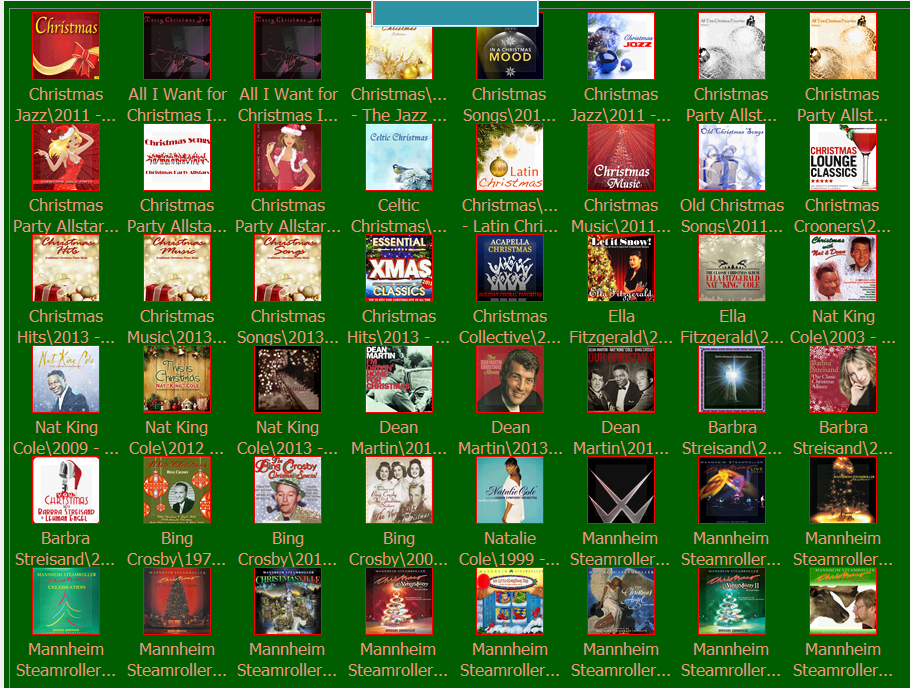

    ... and you can see that all the results contain the word "Christmas" for the Album name. All are from Bing Crosby because that is what we asked for (no wildcard given there).

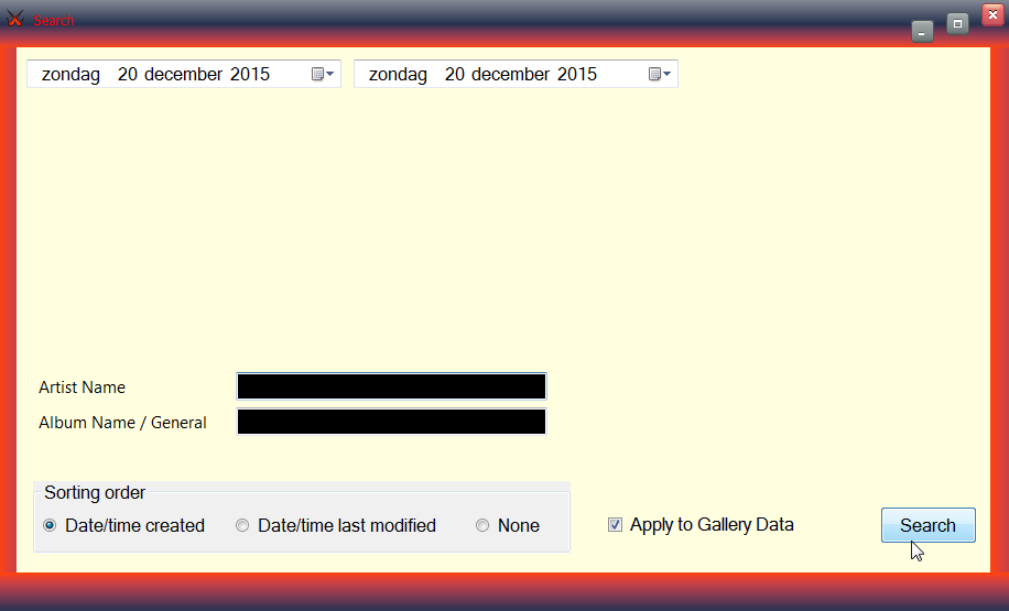

  • This applies to XXHighEnd in general and not to Tidal Search only :
    Above you see that a Sorting Order has been chosen (see line at the bottom). You also see that a date range has been chosen, in this case a span of one day. Now :
    What you see here is all what was new for that one day (December 20, 2015). In this case this is about all what was "Prepared" from Tidal on that day, but this is coincidental because it just shows everything which complies to being new for the given date span.
    What functionally happened, obviously, is that some Christmas music was prepared for sue Christmas day(s).
    Now notice that this actually was already there since many years, but that it was quite unusable because of the lack of speed and not remembering the last choice etc. (this is largely about intuitiveness and if you tried to use this previously, you really should try it again, now).
    In the end this is the most useful a.o. things it allows you to Prepare a bunch from Tidal, which you want to play later - like in this case. All we need to remember is when about this Preparation took place (like Dec. 20 here) and ask for all of that data again.
    Last thing : The Apply to Gallery Data is new and it allows to NOT access the Original Locations and just the Date of Obtainment in the Gallery of concern (see your Library Area of the moment) instead. This is not only functional in itself, but it also speeds up largely, because the physical disks holding the music (the "Original Location") don't need to spin up.

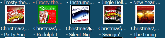

  • Look here :
    The middle one, where the mouse pointer is at, has a black border. This is new;
    In the previous version, EP's and Singles were filtered out because of, say, personaly preferences (but call it a bug). Now their metadata is downloaded just the same, but they receive a black border (until something is done with them, like you see by the green border of the second one - which one has received its Track Metadata).
    Please notice that often EP's / Singles are not denoted as such by Tidal, and thus can also not receive a black border, while they are EP's or Singles anyway.

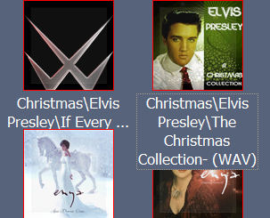

  • It appeared that it could happen that a Yellow Bordered Album received that Yellow border because just one of its Tracks was found to be in the wrong format (not 16/44.1). So because of that, the whole album was rejected;
    Now it is so that only if the first track is not 16/44.1 the whole labum is rejected right away; if a second or any other is rejected, but the first one (and more) are OK, the ones which are OK just stay and the rejected ones are not obtained.

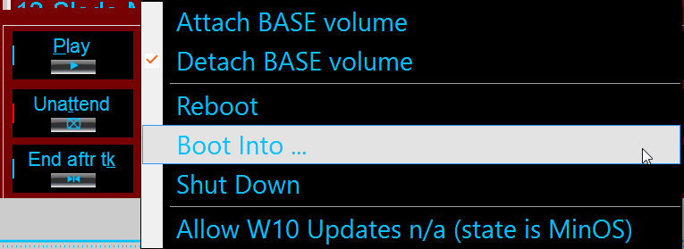

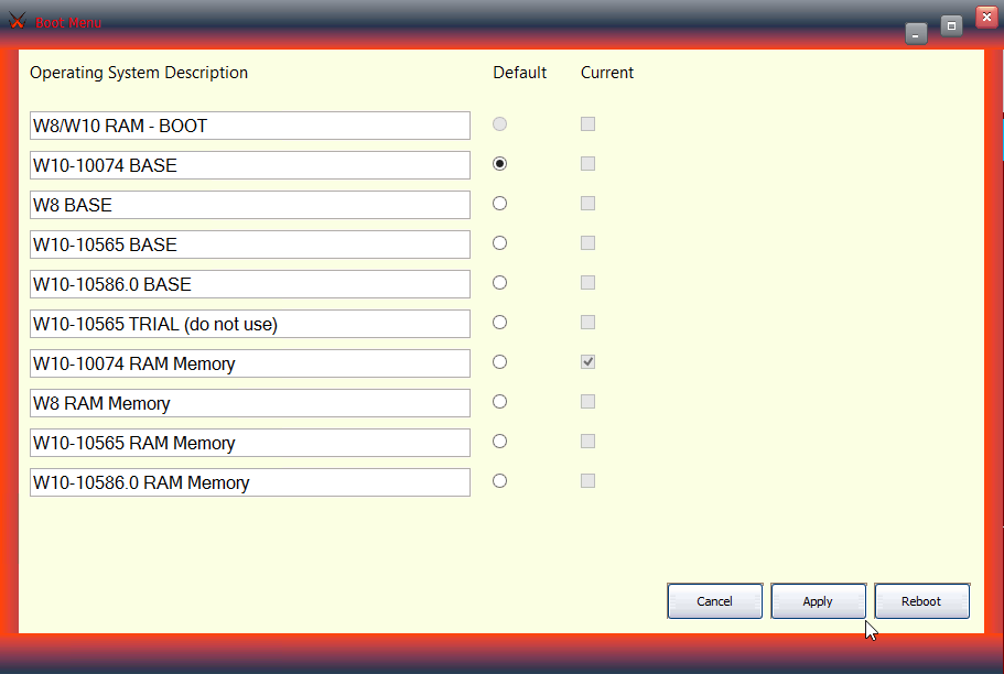

  • RightClick on the Stop Button now show this :

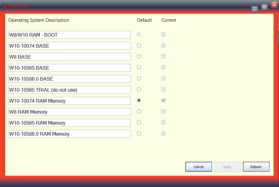

    The new option "Boot Into ..." allows us to Reboot into one of the Multi Boots as defined for our system.
    Warning : This is to be considered software in beta stage, as it has not been tested on systems others than ours plus that it was created for a specific purpose : The OS from RAM boots. However, for the more normal environment it can work just the same so it is now offered as explicit functionality.
    What does it do for you :
    -> On the Remotely Controlled system (like with RDC/RDP) it allows to choose which Operating System to boot into, which normally is not possible without connecting the Monitor, Keyboard and Mouse and possibly even the Video card (to be inserted). In the end it is the most convenient, assuming that people remotely control their Audio PC indeed.
    Meanwhile it actually allows for pre-selecting the OS to boot into, meaning that the selection happens when the current OS is still running. Thus : Select OS to boot into - Reboot.
    Keeping in mind that this is part of the OS from RAM boots and necessary control, this is the screen coming up when a physical "BASE DISK" is mounted in the PC (Phasure provides such a disk/ssd) :
    This is the sitation as per end of December 2015 and later we will see other Operating Systems / versions appear.
    At this moment (XXHighEnd 2.04) only the OS to boot into can be chosen. These are the Radio Button in the "Default" column. What you see above is what comes up at first. In this case it is the "booted from RAM" version of Windows 10, Build 10074. And, when you'd select e.g. the BASE version of that same OS, like here :
    ... then you see the Apply button now being available, and when you'd click Apply the system is ready to Reboot into that W10-10074 BASE version. Use the Reboot button or any other means which implies a Reboot (including Shutting Down and Boot the next day), you will be in the newly chosen OS.
    Remember, you can do all this from behind your remote control - also iPad etc.;
    Want to check the SQ of that other OS ? well, what's implied above will take maybe 30 seconds and you are up and running again, listening to the same OS but now running from HDD/SSD and not from RAM.
    Side note : A Boot from a HDD/SSD takes maybe 30 seconds, while a Boot fram RAM takes about 2 minutes when from a "fast" SSD (Phasure provides that).
