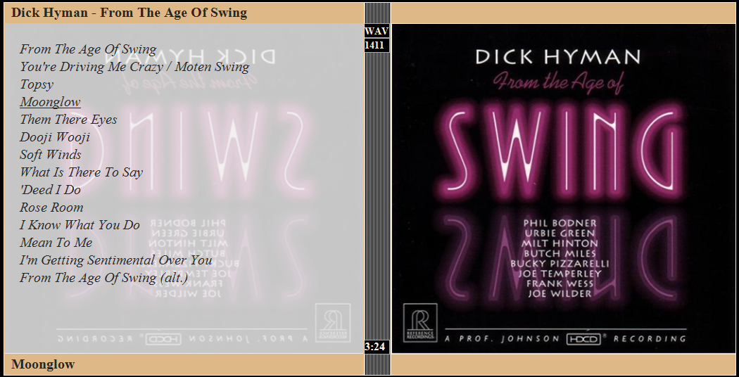

  • The means of WallPaper visualization has been changed;
    First thing of importance : The number in the Settings Area before indicating the Height of the WallPaper to maintain, now has been changed to the Width. Internally the same means is used to determine this, implying that when you before used a setting of e.g. 590 for the Height, now the Width will become 590.
    As you can see from the picture below from now on the front as well as "the back" of the CD is shown. Along with that, the back shows the tracks on the album. Note that this is not related to the current Playlist ... it is just drawn from the album, no matter only one track of that album has been selected.
    The area for the album title at the top as well as the area for the trackname at the bottom, are longer now, hence longer titles and track names can be shown in full. Not though that when longer than the left half, they wil go right through the middle of the "tray".
    The same accounts for the track names shown; when they are too long they will not be cut, but will extend to the right part, hence the coverart.
    Note that the currently playing track is underlined (like "Moonglow" in the picture below).
    Issue left : Unlike within XXHighEnd itself, lacking track numbers are not shown. This is for later to solve.
    Similarly, the running track times are not shown. Also for later.
