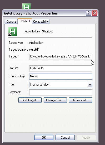

A. Create a folder c:\AutoHK (you may change this later but at this moment name it exactly like this !);
B. Copy the above mentioned files in that folder;

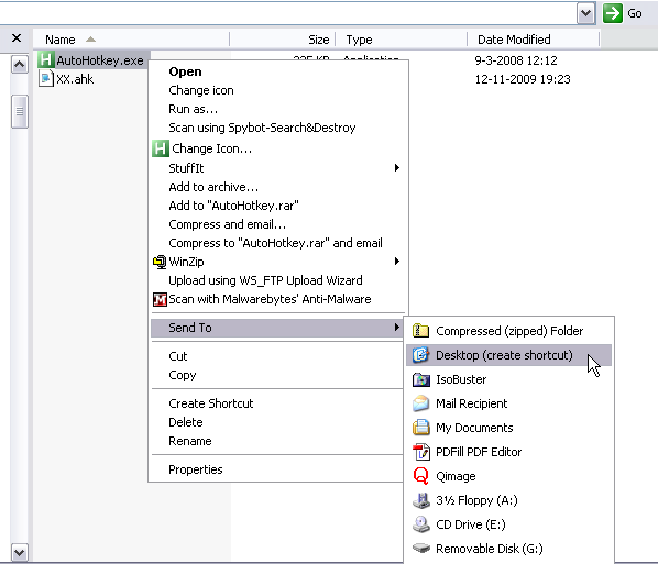

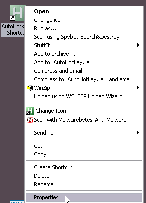

C. Send the AutoHotkey.exe file to the Desktop, so an shortcut icon will be there; This can be done from explorer. For XP this looks like this :
On the Desktop a green icon with an "H" will have appeared; Rightclick that and head for modifying its properties :
Fill the Target line with the location of AutoHotkey.exe (but that should be readily there) but also incorporate the parameter (second part of the line)
c:\AutoHK\XX.ahk :
Remember, this assumes the c:\AutoHK folder to be used; You can use another folder, but changes the name in the shortcut accordingly.
Finish this part with also filling in the "Start in" as shown, click Apply and OK.

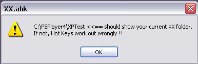

After the latter has been done at least once, now doubleclick the desktop icon from AutoHotkey (the green H).
This shoud show similar to below picture with emphasis on the "c:\PSPlayer5" part, which should show the path to your current XX install.
This tells me that my current XXHighEnd version is contained in the c:\PSPlayer4\XPTest folder.
The message confirms me that AutoHotkey will be using the XXHighEnd.exe (at remote commands) contained in *that* folder. Because remember, you can be having several XXHighEnd versions hanging around, but only one can be controlled by AutoHotkey. So, how do you tell AUtoHotkey to use which XXHighEnd version ?

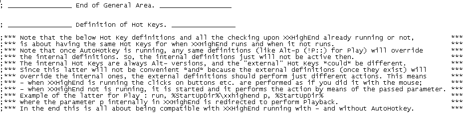

Now. *if* something is wrong with the script used - hence it is the wrong one which will be the default one when XX.ahk could not be found, you will NOT see this after 35 lines or so from the top :
So, there's a clear indication this is about XXHighEnd, which wouldn't be there when the default script is coincidentally run.
Do *not* change anything in there. Or at least not now. You may do that later, when you want to change your HotKeys.

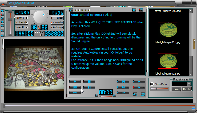

Now we are this far, it is good to remember what we are doing this for : Control Playback in Unattended Playback mode. What does this mean ?
It means that XXHighEnd as the controlling user interface won't be there during playback. This way sound quality is better *and* the GUI can't interfere with the sound quality. This latter is important for the development, so the development of the GUI and all can be done without thinking about the SQ influence (which *really* is there !). Notice how to run XXHighEnd in Unattended mode :
It's the button at the mouse pointer which should be active (click it once and it will be active (see red led); click another time and it's inactive);
If you now click Play -which is the button above it- (or use Alt-P), the interface and whole program will disappear before playback starts. Notice though that this can take some time, depending on several factors, the first being the length of the Playlist Area (number of tracks in there, but also how long they are for play time).

More ways are possible, and for instance the script may contain a "hot key" named "Play::" which can pass through to the existing !p:: (don't try to understand this right at this moment !!).
