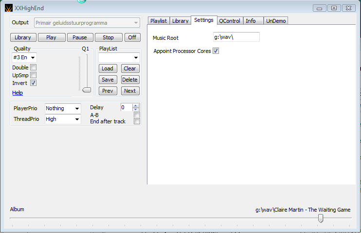

If you tick the checkbox as shown in XXCPU01 below, your PC will be changed into an Audio Dedicated Machine. wub I am listening to such a device right now, and I can tell you ... chicken skin. Brrrrr.

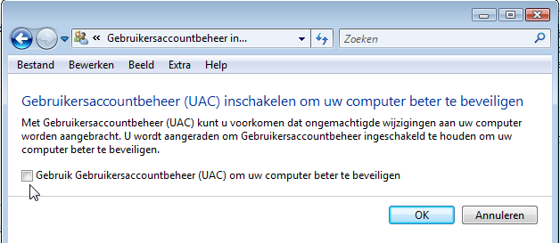

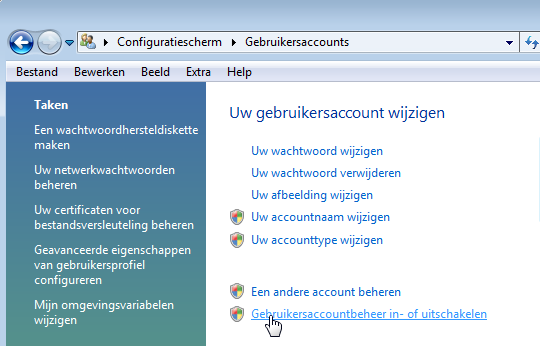

Now, there are two main methods on how to arrange for that permanently (in all cases you must have Administrator Rights ! (which everybody usually has)) :
  • DISable UAC (User Account Control);
    Look at XXCPU03 below. Choose the appointed option.
    Now look at XXCPU04. The checkbox there is ticked by default. Untick it.
    Note : This avoids the ever asking questions "Are your sure ?", "Really ?", "Really sure ?" and all the nonsense.
    In fact now you're done. BUT :
    There is a major downside to this way of working. This is about when you Install things, they might not install as intended. You will by then have forgotton about this, and won't be able to proceed the whatever it is you wanted to do.
    So use this option only if you don't forget about this ...

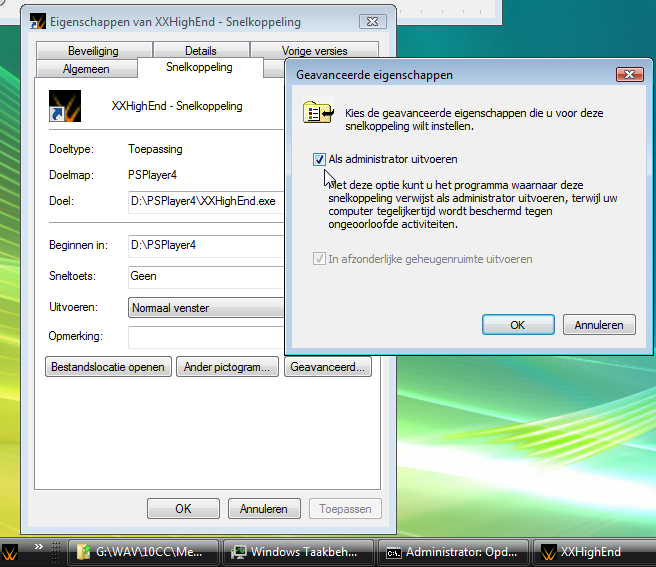

  • Appoint both XXHighEnd and Explorer for Run As Administrator;
    Look at XXCPU05 below. In the left bottom corner you see my XX Icon (you might have it on the Desktop). Rightclick on it, and choose Properties.
    Choose Advanced and the righthand screen pops up.
    In there, tick the checkbox as indicated.
    Now do the same for Explorer;
    Look at XXCPU06. In the left bottom corner you see Explorer's shortcut icon. If you don't have one yet, make one (can be on the Desktop just the same).
    Here too there's a downside : Each time you start XXHighEnd / Explorer there's one "Are you sure" question again.
Btw, note that you also could start the programs each time with rightclick on the shortcut icon and then choose "Run As Administrator" from the context menu ...

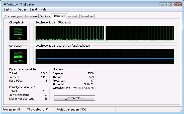

« Reply #1 on: October 07, 2007, 10:29:24 pm »
When all settings were made according to your post and the new checkbox is checked and it is playing does this mean that it is working on my PC? Or should I change the processor(s) settings too.
All settings were already set the way you mention though, I only needed to check the checkbox.
I do have an Intel Core 2 6300 processor (showing 2 of them) but not an E-type or Duo (as far as I can see) and have no clue about hypertrading and such...
« Reply #2 on: October 07, 2007, 10:40:12 pm »
Hi Bert,
Yes, then it should be working. The graph of the cpu useage should look similar to the screencopy I showed though. When not (hence the right part shows siginificantly more useage) we can (and will) dive into things.
There's Hyperthreading processors (the old "Pentium"), DuoCore's (like you have I think) and the Core2Duo's. And the real dual or more processors of course (which by themselves can have more cores, or "Hyperthreading").
The newer, the "more official" for separate cores. To what extend they contribute to appointing the tasks as XXHighEnd intends ... we'll see.
« Reply #3 on: October 07, 2007, 10:55:44 pm »
Seems to work...  Wink
Too "drunk" and tired to listen seriously though...  innocent

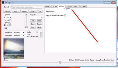

Well, I have it working here as per your settings. Right now I'm running Q1 -3 inverted or 13 unchecked polarity.   Appoint Processor core checked.  When I installed Vista a while ago I had got rid of multi users by unchecking that a long time ago, has always booted right to desktop.. never typed in passwords when I install, I've always had admin from boot.  I did check mark shortcuts of explorer and XXHE to admin privileges, but it doesn't ask each time I start XXHE/explorer "Are You Sure"... so don't know what you mean.  Anyway it runs and is playing music.  Laptop has a Pentium M735 1.73 GHz cpu. Code name Dothan cpu.  2 Gigs of ram...I'm guessing I have a dedicated audio pc working as you outlined?
One thing that is different than your pic in XXCPU01.png is that the box next to Music Root is Not next to Music Root in my setup, but down in the middle of the window.... What is that Music Root box for?
Would you care to post a screen copy of that ? (the full window of XX please).
« Reply #8 on: October 08, 2007, 03:32:37 pm »
I got that to... But the place of that wil change when you make the screen smaller or bigger. I don't know how to make a copy so i will leave that for someone else..
« Reply #9 on: October 08, 2007, 04:23:59 pm »
quote]
[/quote]
The Path "window" moves up or down when changing the height of XX, no need for a screendump. Just make XX higher and you will see yourself...
« Reply #10 on: October 08, 2007, 05:20:30 pm »
Path window ?
I resized the screen, but I don't see anything I'm not used to ...
« Reply #11 on: October 08, 2007, 07:26:18 pm »
Vertically changed the size too (height)?
« Reply #12 on: October 08, 2007, 08:37:14 pm »
Ah ... *that* !
Ok. Thanks !

« Reply #13 on: October 09, 2007, 12:45:08 am »
Hi Peter
I'm struggling to find the right boxes to run as Administrator. Can you paste an English version of 05 and 06
Ta good
Chris
Then to SW1X Signature DAC
« Reply #14 on: October 09, 2007, 08:55:14 am »
Hi there Chris,
Sadly, I don't have them. But maybe I can explain :
XXCPU05 (06 is the same) :
1. Perform rightclick on the shortcut icon (XX and Explorer respectively).
2. Choose Properties from the context menu that appears after 1.
3. In the screen then appearing, choose the Shortcut tab.
4. In there choose Advanced.
5. In the screen then appearing (the right hand screen in the picture), choose Run As Administrator.
6. Press Ok. The screen disappears.
7. Press Apply in the other screen. Press Ok.
Remember, *if* this is your choise of going about. See first post.
HTH,
