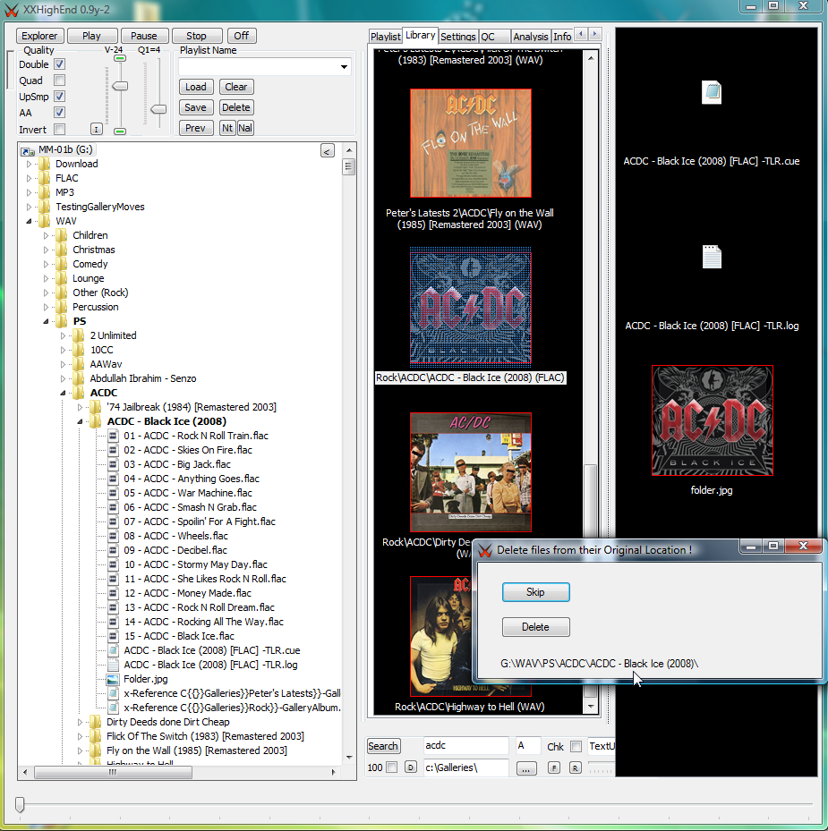

    Look at the picture below; It nicely shows in Embedded Explorer what is going to be deleted (which would be the deepest bold item), and the small form awaitening your confirmation or Skip to the next (marked for Deletion in the Library Area), or just to cross away the small form at all (quit the Delete activity) ... during that small form is there you can easily browse Embedded Explorer to look whether it indeed is allright what is about to happen.
