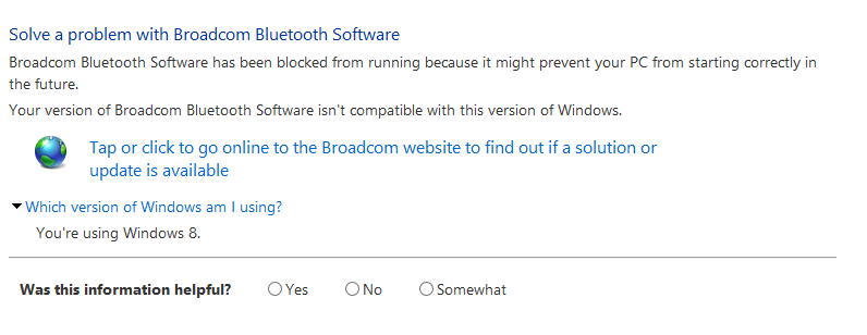

Hi Peter - it is not the end of the world if I cannot use remote but it would be nice to have again sometime  unhappy. But look at the message that W8 generated.
I did actually achieve a bluetooth pairing without problems so I thought it would be the RDC that was the problem (and in fact the system problems only occurred after attempting to use RDC. Maybe it is some interaction between the two.
By the way I always boot to full O/S to load software and make any significant changes.
Not sure why I got this error message as the Broadcom download shown on their website is the same and that is W8 compatible.
Cheers P
