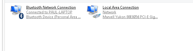

I have established a Bluetooth connection between my PC and laptop for RDC of the PC but cannot get RDC to work. Using the IPv4 address shown for the Bluetooth connection RDC will not connect but using the IPv4 ip address for the network connection works OK.
I have run out of ideas just now so if anyone can help I would much appreciate it.

« Reply #1 on: January 27, 2013, 10:29:47 am »
Paul, first a small question :
I can't keep track of everything, but did you ask for the Bluetooth driver (by email) ? I don't recall it.
When not, I don't even see how you got the driver installed.
When I'm still on the right track, tell me how you accomplished *that* (only because I couldn't with the standard one).
But maybe I'm on the wrong track !

Peter - yes you did send me W8 bluetooth driver and that is what I installed on the PC. The laptop is windows 7 so I did not install the new driver on the laptop - should I?
Alain thanks - everything seems to be OK in remote connections security setting.
