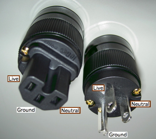

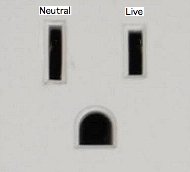

I never really cared to ask this, but I tend to overlook this question... I found two pictures showing from what slot the live voltage is supposed to be here in Canada (and I believe it is the same in US)...
The 2 pictures that you can see are showing where the live current is located (which prong) as opposed to the neutral one.
I think it could be interesting for each of us to tell where the current flows as opposed to the neutral - this on a cable with the appropriate connection for the socket wall on one extremity and the IEC side (Is it the same for all ?).
So I will start...
Here in Canada, this is how it is done...

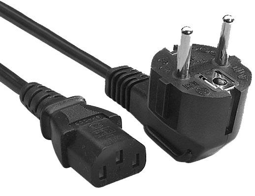

Over here it depends on how you plug the plug in the wall. See picture below;
You can see that this plug can be put in eithet (180 degree) side. And there is really NO means to determine here for us how it should be done the best, other than measuring the least current flowing between devices (we have beepers for that but it can just be measured with actually a volt meter).
So, do the one device such and the other device so and ...
And then we still don't know because now it depends on how the device is wired (so you question).
For this reason I actually never in my life thought about this while I can imagine that it matters for the absolute best connection; we just twist the plug, while you can not do that.
So you see, it is just no "question" over here. And yes, I now wonder whether other manufacturers ever think about this.

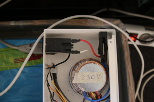

Anyway, all I can tell is that each NOS1 will be wired exactly the same regarding this, but that won't help you much. So ... I just made a photo to show it, and I attached it below anyway, but it is of now use because ...
Well, because "how are the wires connect to your wall outlet ?"
So yes, you can still switch those red and white wires you see in the bottom picture and try, but it still won't lead to a general rule for everybody (who can not twist the plug in the wall).
What you could do - and I would do that - is make an extension block with these euro connections. Plus euro cables (see first picture). Then you can switch everything for the better/best.
