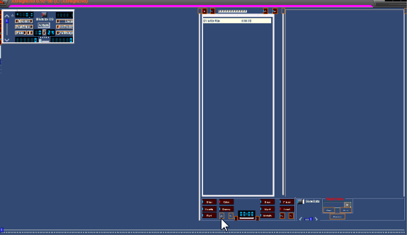

« Reply #6 on: January 01, 2014, 12:46:23 pm »
No, that doesn't look like anything normal.
See first attachment and the mouse arrow. That's the [ S ] button (yea, hard to find the "S" for you).
Then see the 2nd attachment, with for me unsure whether that screen (appearing after pressing tthat S) also is so small. Anyway, see the line with the mounse arrow again. The box to the left of it needs this scaling factor. Now careful (if you actually can't read it); best is to try to clear the field, enter only a 1 (so not a dot or comma), press tab and then click that button where the arrow is.
That should bring your screen in Scale 1 which is readable enough to enter the proper value (default 1.4).
I am saying it like this, because I don't know whether your PC accepts comma or decimal point and when you enter the wrong, things may get wildly large. So once when at 1 you can see what you are doing.
If this doesn't help, shoot back.
Btw, I have never seen happening such a thing (from anyone).
PS: Once back in business, notice the [ 1 ] and [ 2 ] buttons in the top, which can be dragged to have the proportions of the screen parts to your likings again.
Also, after rescaling, always quit and restart to see the real result.
