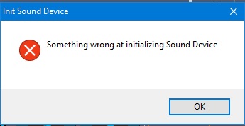

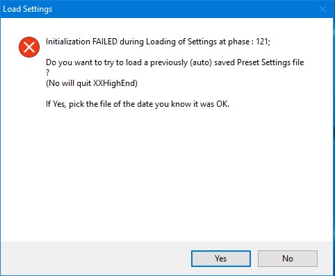

I decided to update my stand-alone RAM-OS HDD (not the one that came with the Mach II, but the one I purchased independently).
The RAM-OS HDD already had 2.06a installed, which was working perfectly. I installed the 2.07-over-2.06a files into the 2.xx folder. I tried starting 2.07 and got the first message attached below. I also got the second message at some point - I can't remember exactly when because I've tried so many other things since then that it's all become a bit of a blur.
Right now, no XX versions will work. As soon as I start them, I get the second message immediately.
Any ideas?
* Initialization Failed during Loading of Settings at phase 121.jpg (32.7 KB, 482x398 - viewed 793 times.)

What I meant with the plural is that neither 2.06a or 2.07 now works. I tried 2.06a just before I loaded 2.07, and it worked perfectly. I did this specifically because I hadn't used this RAM-OS HDD for quite a while and just wanted to make sure everything was OK. So 2.06a used to work fine.
After launching 2.07 and getting the error messages, I thought I'd just try 2.06a. But it wouldn't start at all. I then messed around with UAC settings and managed to get both 2.06a and 2.07 to actually launch, but only up to the point of getting the error messages (attached in earlier post) - the error messages are identical for both 2.06a and 2.07.
