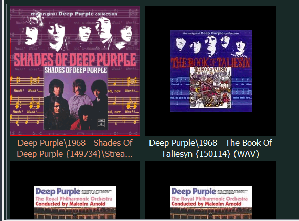

I have attached another image (3) showing coverart of 3 albums, which are streamed & placed in the Streams folder. 2 of them don't show the red border & one of the doesn't have the \streams in the naming. Is this something to worry about?

The Red Border you see is not really Red but purple (as far as I can see). It only applies when being in the TT folder structure (Intermediate Files) and I can't see whether you are or not. Purple is for "done partly") Or maybe even nothing happened to that one (seems more logic to me) because it just has that colour.
The Streams part only occurs when you Prepared the album. So without that (only searched for on Tidal) it is not there.
Ask more when needed.

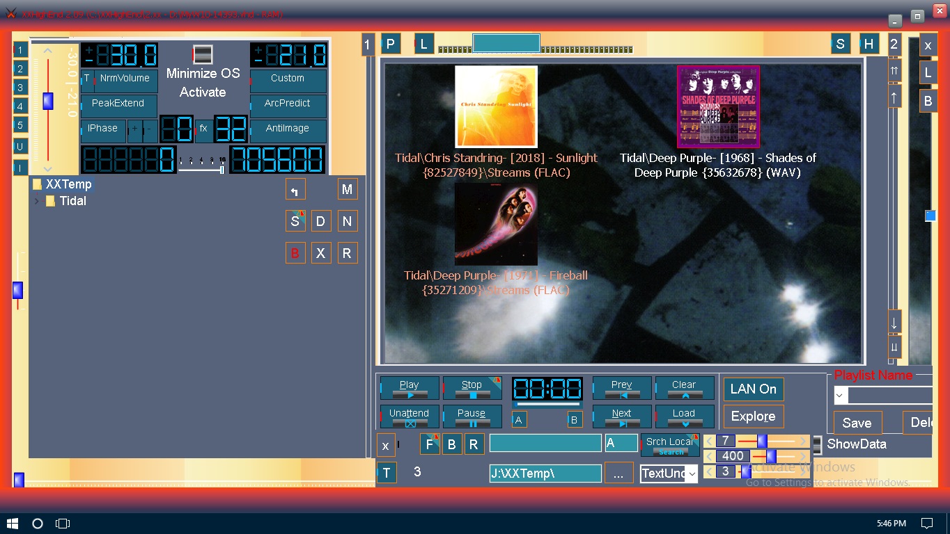

Well I can see all 3 albums in the streams folder (Temp). In the image (above) you can see that they are in the Temp folder.

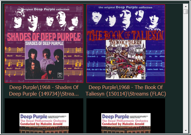

I checked it for you, and it is so that a Prepared Album automatically changes from the "native" folder to the \Streams folder. Well, almost automatically because it needs a refresh of the Library Area (like DoubleClick in the search field accomplishes that).
So first one below shows the end result of Shades of Deep Purple. The Book of Taliesyn wasn't touched yet.
Second shows The Book of Taliesyn when it was Prepared.
Third shows the lot after a refresh.
And all is still in the Intermediate Structure.

I prepared streams of 2 albums in the Intermediate folder, image attached (1).
Out of the 2 albums only one (Deep Purple in rock)  moved to the streams folder, the other (Burn) didn't move. In spite of repeated attempts.

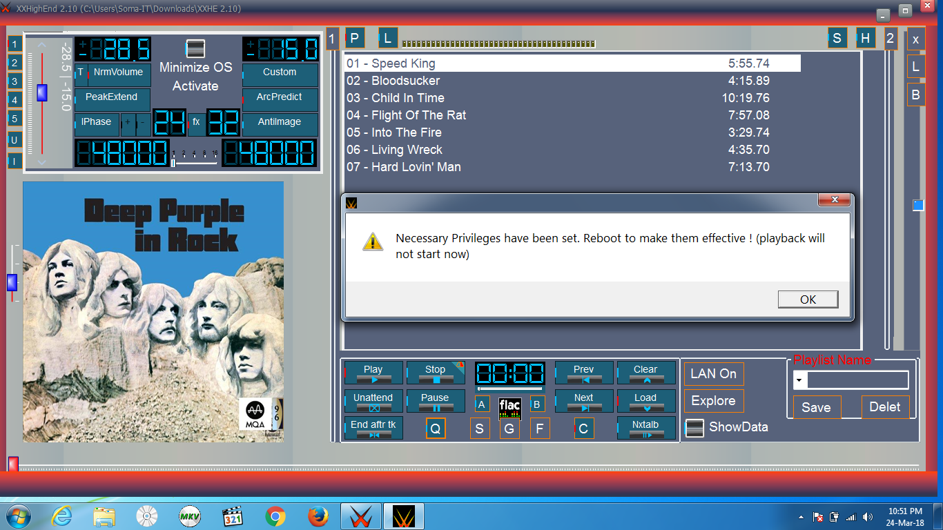

When I tried to play the one that moved to the streams folder, from the Music Server PC, it doesn't play & I get a msg, which is attached (2). Even after rebooting, the same msg appears.
When I tried to play it from the Audio PC, it also doesn't play either. No msg in Audio PC.

Again I can't do much with this because you take too much assumptions without shown proof. Of course, if you'd know for sure what you are doing I'd believe you unconditionally. But you don't and so I can't. Happy
You mix up so many things in one go now (and you don't see it). Here's your sequence again :
1. Throw all out once again, please;
2. Search for normal albums (not MQA !) - Prepare one and one only.
3. Move that to your Tidal folder. Reattempt this when you receive an error message (as the message itself advises) unless it really can't be done and then show me the message.
4. Take care that on the Audio PC you have denoted the Tidal folder. Go there explicitly by means of the Search button and the "Tidal" RightClick selection.
5. Play the album for a bit, and play it on your Audio PC *only*.
Note : Your music Server PC was not set up for SSXHighEnd Audio Playback (never mind you think it was) - so don't even try it (and lock out things mean while !).
You will see that this works now.
That assumed, proceed to step two. Pick that step yourself, as long as it implies one new step only and not four+ (really !) like now. Postpone MQA as long as possible because it implies more potential anomaly. First get used to Tidal itself, please.
We could call it baby steps for now but it is not about that. It is about the one thing obfuscating the other and with new things nobody can bear that. no
Peter (here to help out further)

From your first picture, "Burn" album is not prepared (no skinny red border yet). That maybe why it refuses to be moved.
Respectfully,
Zheng
