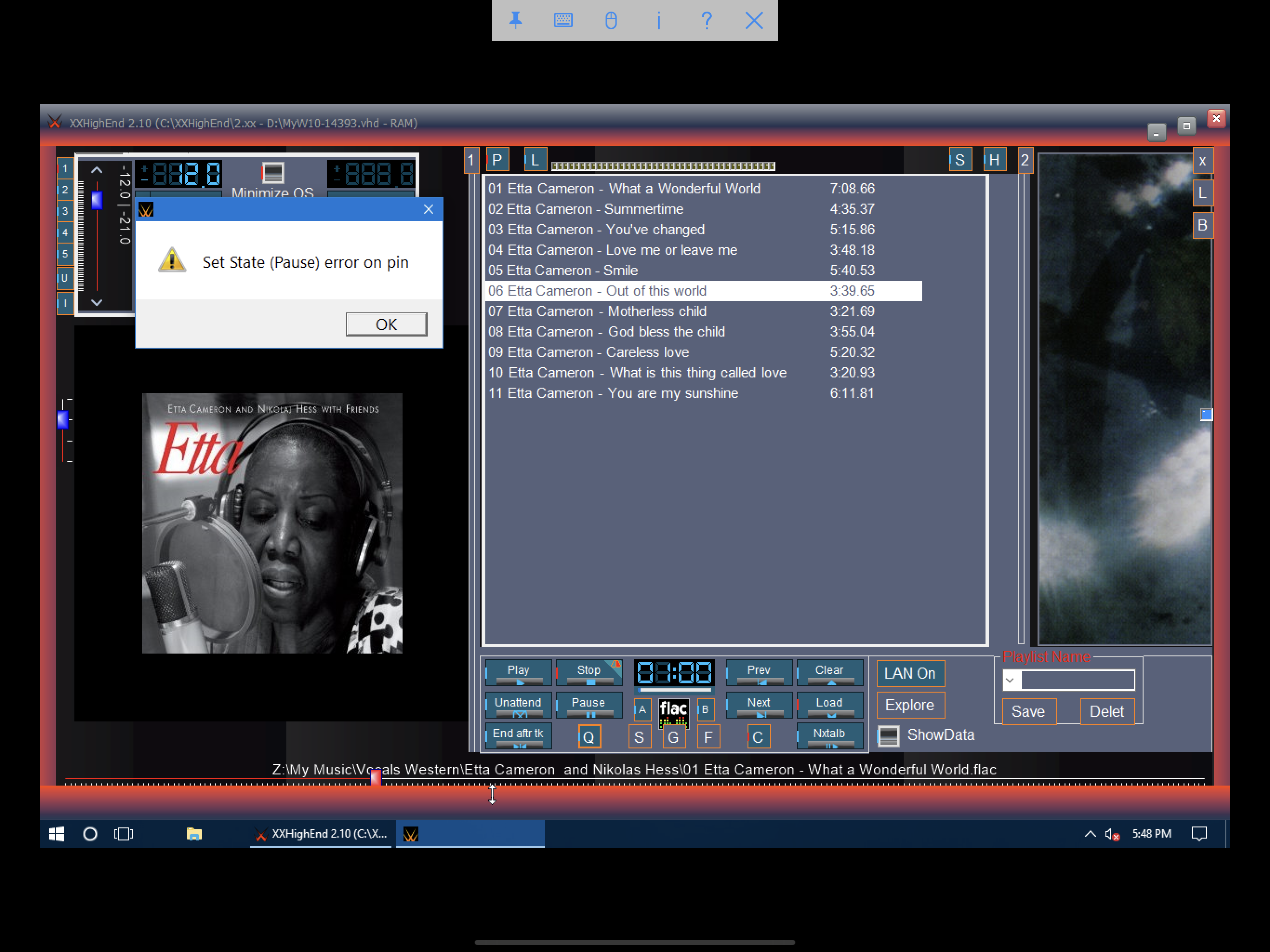

Dear Peter,
When I started the xxh program today this message flashed on the screen :[ Set State( Pause) Error on pin ] & no track was playing. I have tried rebooting the system but its the same.
What should I do?
shreekant
« Reply #1 on: October 15, 2019, 05:48:37 pm »
Hi there Shreekant,
Take out the USB cable at both sides, but it back in (both sides) and switch off and on the NOS1.
The message comes from the DAC, no sudden odd XXHighEnd setting implies the problem.
Let me know whether it helped …

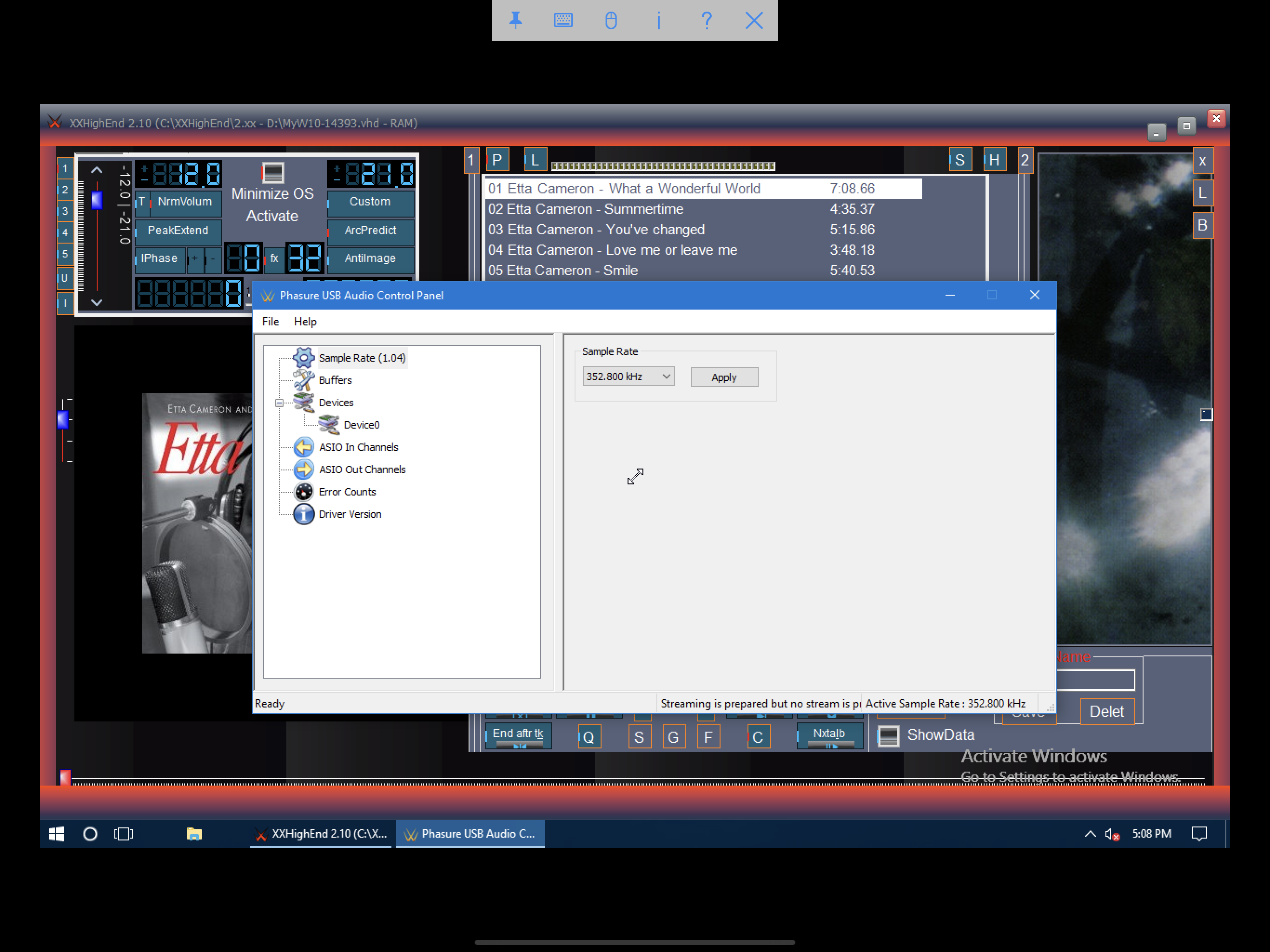

Shreekant Somany
Posts: 63
« Reply #4 on: October 16, 2019, 02:10:06 pm »
I changed the cable there is no difference.
I have attached the screen shot of the control panel.
When i play a track, the green Led blinks and after a few seconds stops blinking.
I don’t have a pc but if a lap top can be connected to the Dac I can do it.
Shreekant
