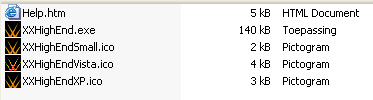

First of all you pointed out that lately there's two EXEs in there, while I never told which one to run (on the just too many pages that deal with that). Indeed it's XXHighEnd.exe.
Then ...
It can well be so that the "install" as how it is since a week or so, wasn't excessiveley tested on XP. And, all what is in there for DLLs and Manifest files is for Vista. So could you please try this :
Remove everything except for what you see in the picture below;
I can only hope for error messages you might then receive, so we can proceed from there.
Anyway, I don't recall a situation that one just gets the Demo message and nothing further (i.e. without an error message). Or maybe I do, but it's too long go to recall what it was about.
Maybe others had the same ?

« Reply #2 on: June 27, 2007, 10:17:56 am »
Ok, I reinstalled Directx again and that did the trick.  It works now.

« Reply #4 on: June 27, 2007, 11:27:06 am »
Thank you Gerner. But for others : the fact that this works for you, sadly, doesn't say much; all depends on the current stage of your system (PC). So, what I intended with a more "raw install" for XP, was getting out of the way the probably error message masking DLLs.
The problem often is : once you get it working, there's hardly a way of getting back to the situation it didn't work (like on a development PC there's no way that things like this can be tested).
Luckily this case is already solved now.
« Reply #5 on: June 27, 2007, 11:35:46 am »
Ah, very good. You are not the first who has to perform this twice. Otoh, I think you had this installed earlier ?  Happy
