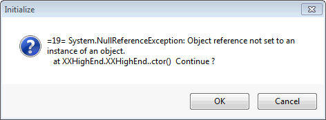

Every time when i start XX i get a error message. After 4 clicks this error message disappeared and the program starts. See attachment

« Reply #1 on: January 12, 2010, 11:51:31 pm »
That is the same as your other post ... something wrong (and unexpected) with the Sound Devices ...
(http://www.phasure.com/index.php?topic=1049.msg8847#msg8847)
Not a nice message, I'll admit.
« Reply #2 on: January 13, 2010, 08:31:48 am »
Every time when i start XX i get a error message. After 3 clicks this error message disappeared and the program starts. See attachment
Just installed y-05 on my main pc (x-fi soundcard, w7 enterprise x64).
I get the same error message, and it requires 4 clicks to go away.
I changed the device din xxhe to x-fi from primary driver, but the message stays.
Tried engine3 and both no upsampling and 4x AP. All works the same.
Will try KS soon and update.
« Reply #3 on: January 13, 2010, 08:59:08 am »
Ok, something else must be going on. Both W7 Enterprise eh ?
Not everything is in there (I know) ... and in this case it is reflecting the Registry ...
Johan (but the question may count for Telstar just the same), do you recognize that you could only play Engine#3 via the Primary Sound Device ? (just in 0.9y-4)
This is not funny.
PS: I forgot why, but I did not get Enterprise (while a normal human being would have, when he had the chance). So whatever it is, you may be in lack of it anyway.
