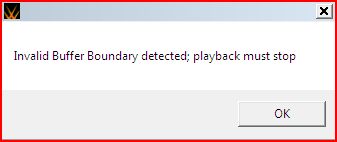

« Reply #3 on: January 22, 2010, 12:08:25 pm »
GOT THIS MESSAGE AGAIN THIS MORNING WHEN SWITCHING TO A NEW TRACK. i DID NOT GET THE WHITE NOISE OR HISS OR STATIC, JUST THE MESSAGE. lOG FILES ARE ATTACHED.

« Reply #4 on: January 22, 2010, 12:11:04 pm »
Hi Per,
Ok, I can't mimic this. Tried everything and all, but I guess too many things are different (you will have read this by now : Re: Windows7 ? hmm ... The Missing Seconds).
Also, the album I have seems not to be the same, because the track times are different.

« Reply #5 on: January 22, 2010, 12:24:46 pm »
Ha, great ! Just because the log files exactly show where this goes wrong.
So, we'll get this one out of the way !
Thanks a lot for your efforts.
« Reply #6 on: January 22, 2010, 03:21:38 pm »
boleary - This has been one of the most trickyest bugs I ever met, with the main question "why does this go right with Engine#3". Well, I won't even begin to explain it, but if all is right it is solved. So, please keep this in mind for y5-04. I won't explicitly mention it in the Release Notes (I wouldn't know how to describe this particular situation), but you know it from here.
Btw, if I look through everything correctly, it is created by your ripping program, which doesn't let end the track at a proper boundary (like a half audio sample). Never mind because it doesn't (at least) harm XX anymore, but it may be something to keep in mind.
Per - if you are indeed able to reproduce this by whatever means suits you, for now you may skip the possible tedious "task" I put you to per my earlier post, and try later, with y-5-04, whether it is solved. But remember, first you must be confident that you are able to copy the behaviour.
I can NOT see how I could have solved your situation, but then I can also not see how this could slip through with 5y-03 (with 02 the protection just wasn't there yet). Also, your situation for sure is different. Thus, what I just have been doing most probably will NOT solve it for your situation. But it may.
