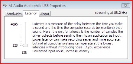

With my M-Audio Audiophile USB I am able to adjust the latency. Marcin, are you able to do the same?
By setting it to its lowest point I am now able to set q1 to 1, though special mode still doesn't appear in the X3PB file. Below that I get distortion. Yesterday, without realizing, the latency was at the highest setting and I had to set Q1 to 7.
I am able to play 24/96 here with no problem.
Okay, not being too techy, I have only skimmed through the posts about latency and buffer size cause, until now, kernel streaming just sounded wrong. It now sounds quite wonderful but very different from engine 3 (I still need more time to work through "preferences"). So could someone breifly explain what it is about latency, buffer size and sound quality that I just don't really understand. I guess I could go back and try to figure it out, but a brief explanation might be easier.....  Happy Thanks.
In my M-Audio Transit the buffer size in drivers options doesn't affect KS a all. The lowest Q1 setting for KS is at 3 for me. Lower I get distortions.
