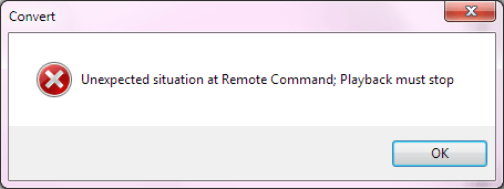

« Reply #10 on: February 23, 2010, 01:55:41 pm »
Update!
Just got it with y-6.
What i exaclty did is: from -15 to -18 without releasing the mouse, then to -16,5 which was my intended target.
The slider is so small that i almost never manage to reach the one step below or above without going farther and then back. But keep in mind, that i dont use the wheel nor i release the mouse button until i find the correct volume attenuation value.

« Reply #11 on: February 23, 2010, 02:04:02 pm »
Ok thank you !
Did the sound keep on playing normally ? or went it into krrrrrr ?
« Reply #12 on: February 23, 2010, 02:43:18 pm »
Ok thank you !
No, it just stops. Then i close the program and start again (the new volume setting is kept)
Posts: 16827
« Reply #13 on: February 25, 2010, 04:48:28 pm »
If this happened while changing the volume when you were towards the end of the track (say, within a minute from the end), chances are fair this is solved in the next version.
