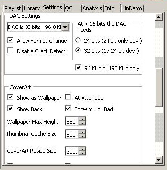

When using Anti image double rate, the memory and processor allocation seems to be much less smooth with y-6 than with y-5.1. And using 96 k only setting and 44.1 k tracks causes many crashes. Using y-6 with arc prediction double rate and 48 k tracks is allmost OK. But there is nothing new...

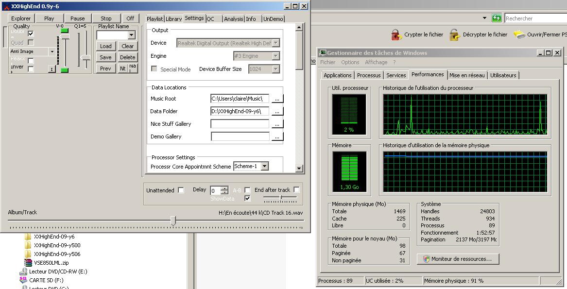

« Reply #4 on: February 27, 2010, 08:54:38 am »
You can find here some pictures.
You can notice the high memory load, much higher than without resampling. The problem occurs mainly at the end, or near the end of a track. It can occur sometimes in the middle of a track, when there is a peak of CPU load.

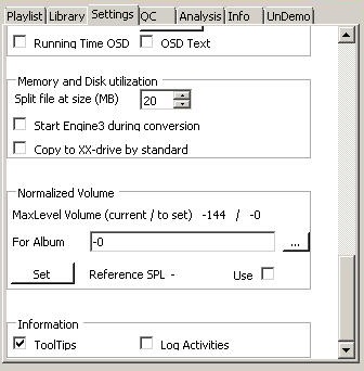

« Reply #5 on: February 27, 2010, 06:52:28 pm »
You are right !
I don't know how or what yet, but it looks like the Split File size setting is not being respected with the AI setting. Good that you have it at 20 in your screen copies, or otherwise I may never have (tried that and) found this high memory useage.
So your problem will be that you are running out of memory at some stage.
I will try to solve it of course.
« Reply #6 on: March 02, 2010, 11:56:37 am »
Solved in 0.9y-7. Happy
