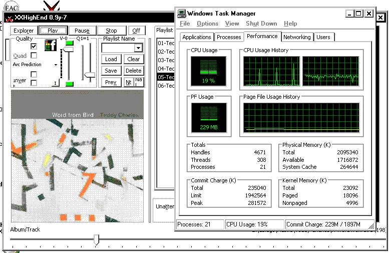

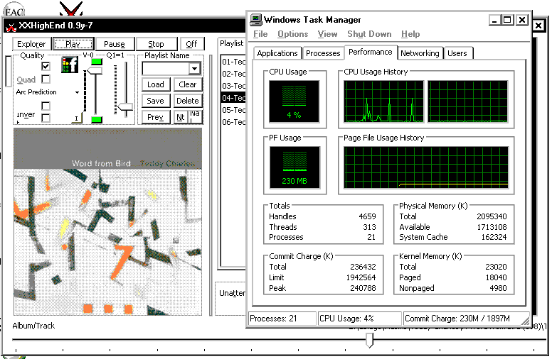

« Reply #11 on: March 06, 2010, 05:15:30 pm »
I made two screenshots: The first shows the right behavior the second the interrupted playing. There is an additional constant load in the second cpu core. The music playing is interrupted when the performance peak arises in the first cpu core. I can hear another characteristic symptom: There is a little relay build in the Beresford DAC which disrupts the output if it is searching for the correct sampling frequency. It is clicking exactly at that time - he SPDIF output ist disturbed.

« Reply #12 on: March 06, 2010, 08:28:48 pm »
I found the problem from the other topic (Weird CPU-usage behavior). Can that be your case too ? (Attended and not show Wallpaper)
It doesn't look like it, but who knows.

« Reply #14 on: March 07, 2010, 01:03:48 pm »
Aha ! That's more than what I have hoped for. Especially since your graph looks completely different from mine (and what I expect from Danny's) -> Spikes.
Anyway, it is solved for the next version.
