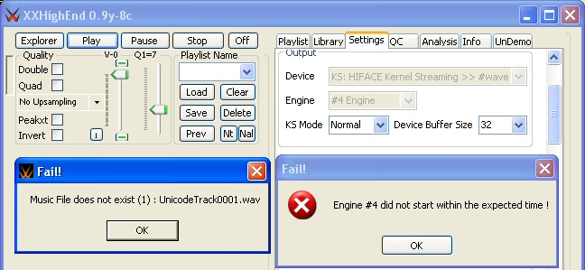

I am trying to use a newly arrived M2Tech hiFace on my XP desktop.
Sadly, I have the following messages (see pictures)
I have no problem to play this 96 kHz 24 bit file with 09y-4 and engine #2.
Best regards.

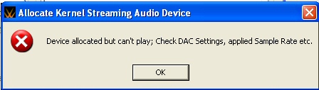

I tried later a 44 kHz 16 bit .wav file.    The first time I had a few seconds of sound, and then the message "Too many buffer errors".
I tried then to play it again. This time I had the message in picture 1.  Since that, it doesn't work any more with foobar (picture 2). OK I think if I restart my computer.
Thanks
« Reply #3 on: March 17, 2010, 03:46:22 am »
The first day I tried the Hiface I repeatedly got the "Device allocated but cannot Play" error with everything I tried to do. Initially, I had to restart the computer every time to get xx to work again. The next day I switched from scheme 3 to scheme 1 and everything worked. Scheme three works for Peter and Mani (See:  http://www.phasure.com/index.php?topic=1161.0) so I would definitely try changing the core appointments to see if you can find one that works for you.
