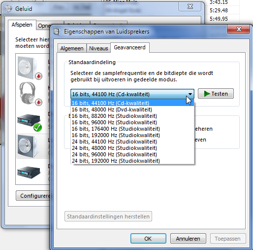

Hmm ... What does the combobox in the Advanced Properties of the sound device say ? Thus, what are the sound device's capabilities ?

Anyway, there are three entries:
  16 bit/44111
  16 bit/48000
  16 bit/192000
The first two work when I click the test button and when I play music using JRMC.  The third one doesn't work.  I tried the first two in XXHE and neither worked.  The manual for the DAC says it is capable of 32, 44, and 48 kHz and that is has "dual-differential Burr Brown PCM63 Series-K 20-bit DACs".

In either case, to me it looks like 16/44.1 should be working, but you are allowed to play just that natively, and no Double or Quad. Additionally you must tell (Settings Area) that your DAC is 16/44.1 or otherwise it will spit out 32 (or 24) bit, and again it won't work.
Let me know if it works with these settings, but if so, next please try to make clear to me where just nothing happens (no sound) while I would say there should be a message of some kind (read : I apparantly must build in such a message where it is currently lacking ?).
PS: DirectSound will work because the OS resamples that to what you chose in that same combobox. Notice that for XXHE the combobox does NOTHING (but theoretically shows the capabilitries of the sound device, which is why I asked for it).
