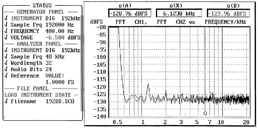

Peter, as a reference for your NOS1 DAC, here are some test results of my particular PM Model Two (provided to me by Dave Peck, the only person qualified to service the Model Two):
1) DAC THD test at -10dBFS
2) ADC/DAC test – analogue signal, converted it to digital, looped from the digital out to the digital in, and converted back to analogue – the entire A/D-D/A chain end to end.
Would be interested in your thoughts...

« Reply #12 on: May 25, 2010, 06:31:43 pm »
Hehe, nice ...
About the first picture, THD+N would be at -115dBFS, but notice I can't see the real output voltage. And only if you know it can do 2VRMS we can assume the -10dBFS to really be there. Also notice that what the analyser says in the left pane "-10dBFS" is just the analyser signal generator setting. So, in reality the output can be less, and THD+N is (or must be) related to the real output signal.
Then, as him to shut off the band limiting. He may say "impossible because then I can't produce an FFT". In that case, bad luck.
I think the "22KHz" in the left pane indicates it is on.
Lastly, the figures in general don't look as filterless to me. But this is exactly why the band limiting in the analyser should be shut off; what is
"lacking" in the DAC is now applied by the analyser !
But maybe the DAC is not filterless in the first place and then it all doesn't say much. Why ? again, because the filter will be ringing, and this can't be measured into THD+N ...
I'll stand corrected including apologizes when I'm completely off here !
PS: For comparison, look at the last picture in this post : World's first NOS 24/192 filterless DAC - Latest Graphs;
Here the output is at -40dBFS, THD+N (because of that) showing at -135dB or so. The difference between -40 and -135 is (-)95.
At that stage in time Arc Prediction wasn't there yet, and instead AI was used. Beware : to playback a file. So, letting the signal generator provide the test tone will never work, because indeed *some* filtering has to be applied in order to make THD good. If it's in the DAC, ok, but then it's in the DAC and rings. If it's done before the DAC, again ok, but now shut off the filtering in the analyser. The latter (filtering before the DAC) is not likely to be anticipated upon for the M2, so or it shows the worst figures when no filter is in there (and use 5KHz instead of 1KHz !!) or it shows nice figures in that case because of the analyser being applied wrongly.
And keep in mind my due apologizes.

I've sent an email to Dave Peck at Euphonix (now part of Avid), so let's see what he comes back with. I would be amazed if the Model Two is oversampling at 176.4/192KHz rates. Firstly, what filter would it be using? It only has a PMD-100 HDCD filter, which just isn't capable of these rates. Also, there is such a big improvement in SQ between using its on-board 4x upsampling and using QAP in XX - I can't see how this could be possible with a filter in play.
I think the first graph may well be at 1fs, in which case the PMD-100 would certainly be engaged. But the AD/DA graph looks like its at 192KHz, if I'm reading the left-hand pane correctly. But you're right, this is probably still band-limited, so of limited use.
In any event, hopefully Dave Peck will reply and we'll know for sure. I know no-one else is likely interested in this, but I certainly am. If nothing else, I want to know why recordings made on the Model Two sound so different to others... they have an immediately identifiable SQ.

Thanks Mani. Notice that I didn't talk about the AD-DA (second picture). Also I must admit that I didn't think about the 1fs when writing, but I saw it too. Of course everything will be different at playing hires files (so, I did NOT think about that during my writing), but still the filter in the analyser should not be engaged.
So, that was apology nr.1. Haha.
