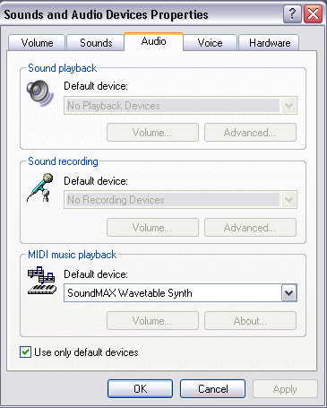

From http://www.audioasylum.com/forums/pcaudio/messages/2/21528.html :
swoonswoonswoon
Quote from: SeVeReD
Engine #2 also works with XP and gets around the 64MB limit, but only works with Primary Sound Driver. My USB DAC is not my Primary Sound Driver and so I can't use Engine #2. (Anyone know how I can change my sound card priorities to make my USB DAC the Primary Sound Driver?)
Go to the tab as shown below and select your USB driver in there. BUT :
What you see there ("No Playback Devices") is probably what you see too. That is, if you shut everything off because of Foobar et al, that what you'll get. I did that too, but with me this is about bit perfect MME (from RME) drivers, which just don't need to show there.
The best option for you would be to enable your USB device in Device Manager, hence revert what you did to shut that off (if you did, that is). Write down what you do to revert it, so you can go back if you don't like XX afteral. I know, to get all (not !!) working in there as should is a hell by itself.

« Reply #2 on: July 02, 2007, 12:13:01 am »
K figured out how to make my usb dac the Primary Device
I had to reverse what I did for foobar to get around kmixer:
1. Open the Windows Control Panel
2. Open Sounds And Audio Devices
3. Select the Hardware Tab
4. Select your sound card in the list
5. Click Properties Button
6. Select Properties Tab on the Sound Card Properties Panel
7. Click on the Mixer + sign
8. Select your sound card on the list
9. Click Properties button
10. Click option box 'Do Not Use Mixer Features On This Device'
11. Click Apply, and then OK.
12. Re-boot
13. Windows Mixer will no longer use the device.
