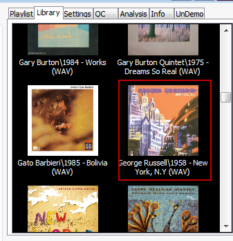

I've noticed in the library area (midle pane) of 09z that some artworks are not shown correctly. The directory of the artist contains a folder.jpg. In version 09y it works ok. What caused this problem?
Johan
