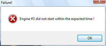

Yesterday I thought that all problems were solved. Short after I had finished mine post on this forum, I have got some error messages only in engine#3.
Today I did a 'reinstall' of XX 0.9d, still in the Vista Business envirement. Here are mine findings:
After one track I get two error messages from Windows :
first
  • "XXEngine3.exe werkt niet meer" ;
second
  • "Failure, Engine#3 did not start within expected time" .
When I look in the task manager I see in the tab "tasks" XXengine3 is still there. XXHighEnd isn't there anymore. On the screen the program XXHighEnd is stil there.
After accepting the errors and via play-button the music continues.  In the active task list I can see XXengine3 and XXHighEnd......
HELP! Shocked
Regards, Johan
« Reply #1 on: July 04, 2007, 02:36:21 am »
Hi Johan,
Not that it immediately solves your problem, but please look at this post : http://www.phasure.com/index.php?topic=94.msg477#msg477 and look at the whole topic as well (solutions for stopping after each track) and notice that Werner too was bothered by the hanging sound).
It would be interesting to know whether the Delay (in XX) of one second helps you too.
Just for your information : The hanging sound you were bothered with is expected to be caused by the driver (http://www.phasure.com/index.php?topic=123.0). I think that *instead* of that happening, now an unexpected situation occurs because of which XX(engine3) dies.
In any case : never always use the same CDs for testing these kind of things, because it might be caused by the CD and the way the tracks end, which often is not official.
Also, do not use offline upsampled tracks (e.g. to 48K !!) to test this because the program performing the upsampling might have written wrong header data into the file (which would be a typicle cause for this problem).
Tomorrow I will change Engine#3 so that it anticipates better on wrong header data vs tracklength, to exclude that problem to start with.
Edit : Actually, the more I think of it, the more I think you use offline to 48K upsampled tracks. Just because you are in the DDDac "community" and over at BDDesign this subject started. This would be Werner's problem too then. yes
dntknw

« Reply #3 on: July 04, 2007, 01:44:22 pm »
What do you mean with offline upsampling? The checkbox "UpSmp" option in XX? I'll never used it.
This was about a thread like this : http://forum.bd-design.nl/board_entry.php?id=11592#p11660, but never mind if you don't know about that and don't do it.
All the testactivities are done without the most famous DDDAC1543. So I connect the headphone direct to the onboard soundcard output!
Ah ! wait a minute ...
So here we will be having another case of "HD Audio Device" I guess ...
But I think your case is different from those "don't want to make sound" and here indeed Engine#3 will be using it in shared mode, and then at the next track it tries to exclusively use itself, can't, quits, and starts at the next track when it can again.
Okay, you can't follow this, but I can. Wink
Anyway this is a case I can't test myself, because this is about a sounddevice not supporting Exclusive Mode (well, that is my guess), but it does allow Shared Mode because the sample rate it supports fits.
Note : which not the case at my place (laptop) because it only supports 48/96 so there's nothing else to do than give an error message (which it does -> "Format not supported", or similar).
The big (in fact huge) pitfall for everyone is, that without being able to look at the effectively output samplerate, you will never (be able to) understand why Engine#1 and #2 do make sound while #3 does not. This is because Vista just resamples to the (by the soundcard) supported samplerate (48 or 96 in my case). Engine#3 avoids just all that, but with the result it can't play.
Conclusion for your situation : This would just be a plain error in my code, and which I couldn't (and can't) test myself.
Johan, to be ahead of things a bit, before I'm going to change the program on this :
When you have sound from #3 by this means of laptop internal speakers ... can you change the volume by the Vista mixer (speaker icon in the taskbar tray) ?
