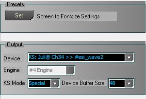

Hi juanpmar,
You can only use adaptive and special mode with KS !?
#3Engine is also #4Engine, so in both cases ks or wasapi, #3Engine is running.
if you doubt you could make a screenshot of your xx settings and post it.
Roy

I think if xx is set to KS mode (see my pic above KS: Juli@ .......) it should play in KS mode, meaning you have sound.
In that same pic you can see the "device buffer size", use that for changing your driver latency.
I dont know if that overrules your normal Musiland setting.
Dont mix up the KS and Wasapi (-ASIO)
Wasapi is what you had first with #3Engine, KS is what should be used for #4Engine !
