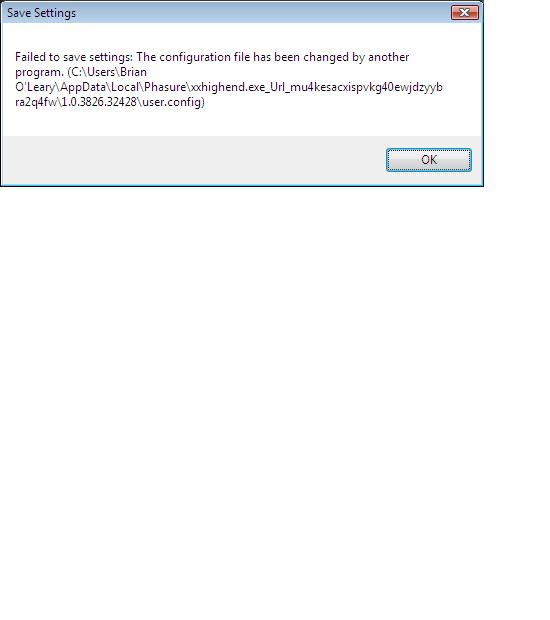

Yesterday the following error occurred when XX went from a 16/44 file to a 24/96 file in the same playlist. (About half the time it works) I had to delete the config file to get things working again.

To me this looks like a clear case of running two (or more) instances of XXHighEnd.
Notice that this includes the situation :
1. Start XX
2. (Much) Later again Start XX, and Quit that.
3. Do something in the instance from 1 (plus Quit I'd say).
I want to add to this that I would say it is just possible to run more instances (as long as only one plays), but a bit depending on unlucky combinations of things and when several threads "doing" things, this might go wrong. If I have had this 3 times, it is much. Never had to re-init the config structure though (not that I recall).
I am not sure what to do with your thinking this is related to the format switching; I don't think the config stuff is even approached when XX is just running/playing; only at Start and Quit.
All can be quite another matter if the config structure was corrupted in the first place. Then things are unpredictable (for me).
All 'n all ... not sure what to do with this !
