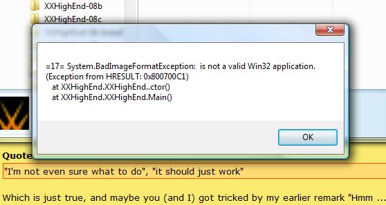

« Reply #9 on: July 10, 2007, 03:25:05 pm »
Hi Peter
I guess you didn't notice my reference to Vista x64 in my very first post... This is the message with 0.9b

« Reply #12 on: July 10, 2007, 03:57:40 pm »
Hey Jack,
It really beats me what you are telling me here. This is from that first post :
I've just downloaded & extracted your files but they only work for me on XP not on Vista x86 or x64.
and
Hello Peter
IT LIVES...DXSetup did the trick, don't see why I should have been missing anything though! OK so now I have the choice of XP or Vista. Reading your help file suggests that my 'best' option for now is XP running on engine 1 with doubling enabled or not depending on taste. I need to install a fresh OS on my audio machine, so my question is, if YOU had the copy of XX that Iv'e got would YOU load XP or Vista?
For your information, Iv'e not had any instability issues in either OS or engine, apart from those heart stopping moments when it checks out mid track! (& yes I know that's built in) From the 2 brief visits to my sounds room, 1 with XP & 1 with Vista it sounds more 'alive & dangerous' than with Foobar (can I say the F word here) so I'm looking forward to getting my ears on this evening for some serious listening. I must remember to pick shorter tracks though! Well done with this, I look forward to being a licence holder....
Regards
Jack
(http://www.phasure.com/index.php?topic=16.msg20#msg20)
I don't get from this at all that you didn't get x64 running (nor that you were all that time waiting for a solution to it !!).
Also ...
The first picture seems to tell that 0.9d-2  wasn't made for Vista32 (which is true for that version !).
Then, your last picture seems consistent with what Edward was telling, except *he* told nothing changed from 0.9d to 0.9d-2. One of you both must be wrong on something ...
wacko
Could you shed a light on what really happened please ?

« Reply #13 on: July 10, 2007, 04:10:51 pm »
Hello
Firstly I am completely happy with XX on my audio pc with Vista 32 & do not need it to run on Vista x64, this is on my main pc & audio server. You said..."It would be nice if someone could confirm Vista 64bit just doesn't startup at all, and gives the message "XXhighEnd does not work anymore". Or that it just does work. Thanks !" So as I implied before if I can help...? I didn't try 0.9d (no need) but do you want me to? If so point me to it.
Still happy Jack
« Reply #14 on: July 10, 2007, 04:29:57 pm »
Ahh, ok. Well, I'll grab that offer with two hands. But first I have to be reset, I think. wacko
Must I conclude that you never got 64 running (hence just not tried anymore) ?
And that today it doesn't work anyway ?
Yes, it might be important to know whether from 0.9d comes the same as from 0.9d-2. Point is, it should, but again Edward told there was no difference. This is also about the 4 microsoft.directx.* DLLs which are there since 0.9d, of which Edward did not tell that removing them made a difference. I think it just does (and then presents the message from 0.9b you showed).
