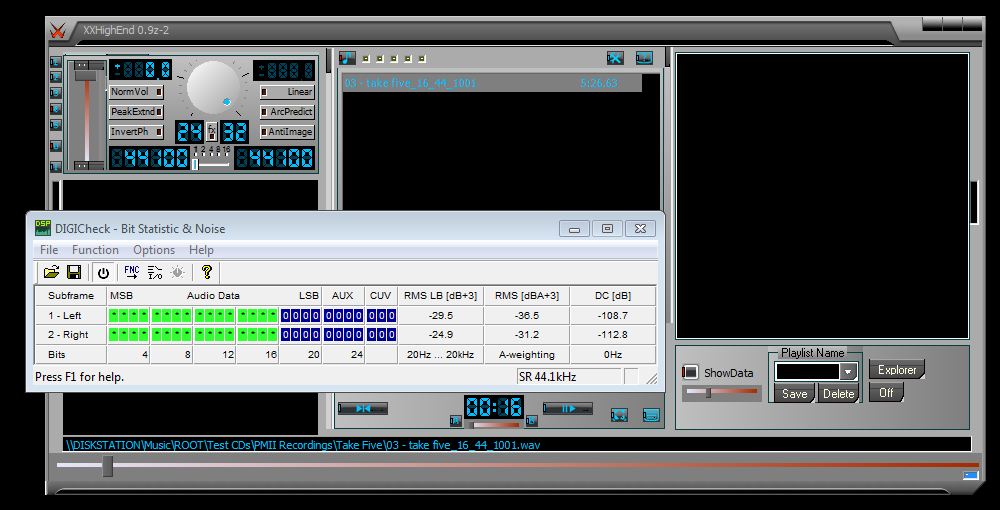

« Reply #6 on: August 13, 2010, 11:57:07 am »
Mani, XXHE indicates 24bit source file with your 16/44 track.
You're right!
BUT... it's definitely a 16 bit recording. I've just verified this with RME's Digicheck.
I'm really puzzled why the 24/176.4 file is only 4 times the size of the 16/44.1 file, and not 6 times the size. This implies that the 16/44.1 really is 24 bits!
What's going on???
[EDIT: I attach screen prints.]
« Reply #7 on: August 13, 2010, 12:18:28 pm »
Just saved as 24 bits files. yes
Ok, as far as I can tell this is totally harmless. Thus, for XXHighEnd it really won't matter, as long as only 16 bits are utilized (and Mani showed just that). The result for SQ would be 100% the same as if it were a 16 bit file.
